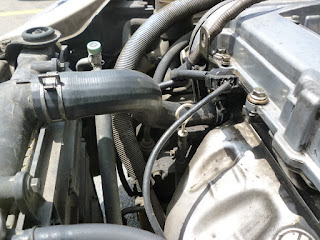

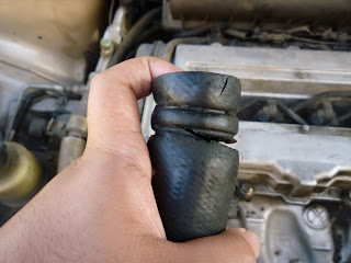

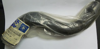

During routine radiator coolant top up activity, i found out that my top radiator hose leaked. This call for short trip to car spare part shop. Below steps I did to replace it.
Spare part:

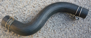

1. 1. Hose radiator up- PN PW823117 (this Part No. for Proton Gen 2)- 1 unit. RM17.00

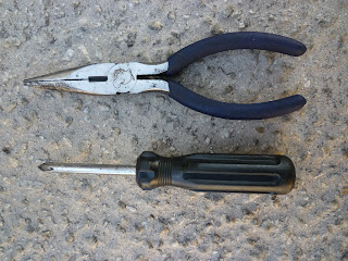

1. Long nose plier. (please get a minimum jaw length of 2 inch).
2. Philips head screw driver. (I'm using the standard philips head screw driver that come with the car.)

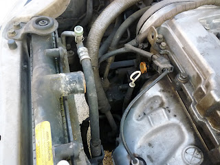

1. Use the long nose plier to loosen the clamp grip on the hose to radiator.
2. Remove the hose from radiator.
3. Use philips head screw driver to loosen the clamp at the engine.
4. Remove the hose from the engine. Picture below showing the engine with hose removed.
5. Take out the new hose from its packaging. Ensure you have the correct parts.
6. Insert both clamp to the new hose.

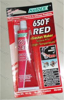

7. If you have gasket maker. Apply it to the outside of the holes and inside the hose where contacts will take place. Best to use a high temperature gasket maker as picture example below.

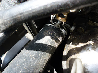

9. Push the clamp close to the end. Leave 1-2 cm clearance from the hose end.
10. Use philip head screw driver to tighten the clamp.
11. Identify the hose end with the bigger diameter. Insert this end to the radiator.
12. Use long nose plier to loosen and adjust the clamp. Position the clamp close to the end. Leave 1-2 cm clearance from the hose end. Below picture with new hose installed.

2. I am a bit surprised that I only use very minimum tool for this work. 1 plier and 1 screw driver only.
3. Radiator hose is made from layers of rubber with some steel wire in the middle for structure integrity. Rubber is susceptible to damage from high temperature (brittle) and oil (dissolving).
4. Age of the car is a factor that may be causing the broken hose.
Spare part:
