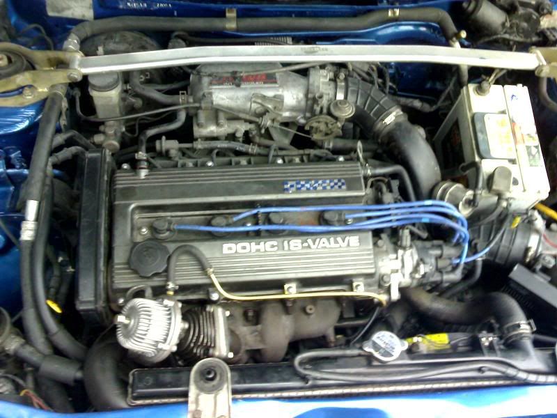

guys, i just install a 40mm thai HKS wastegate to my b8 engine...now i have problems with the boost...it reaches untill 1.5bar to 1.6bar.this number worries me, affraid it will effect the engine and other...
i need some help here to overcome this problem...buying an original one is one sollution...but if i stick to then current one...how meh?...please help :sad_smile:

how did u install them
show us pictures of the hoses
and check for hose leaks
check whether u connected them in the correct way
did u adjust the screw on top of the wastegate to lower boost
wht boost controller r u using
could even be ur wastegate is jammed
without this, we cant do anything

i dont really have pics for this...just this one...dont know will help or not...about the screw...i just screw it in...not deep...minimum...just to close the hole...
will do the hose leaks check...but which hose?...about the connection, i think its right...cause my foreman did it...he did it before to a lot of cars, i dont think he did it wrong...how to check wheather its jam or not?...push the valve?...
im using HKS thailand wastegate...

jambunk : check the hose that enters ur wastegate , ur mech did some modding with metal tiny pipe also , so please do check , does ur wastegate open at all ? what boost does the keretapi sound come out ?
