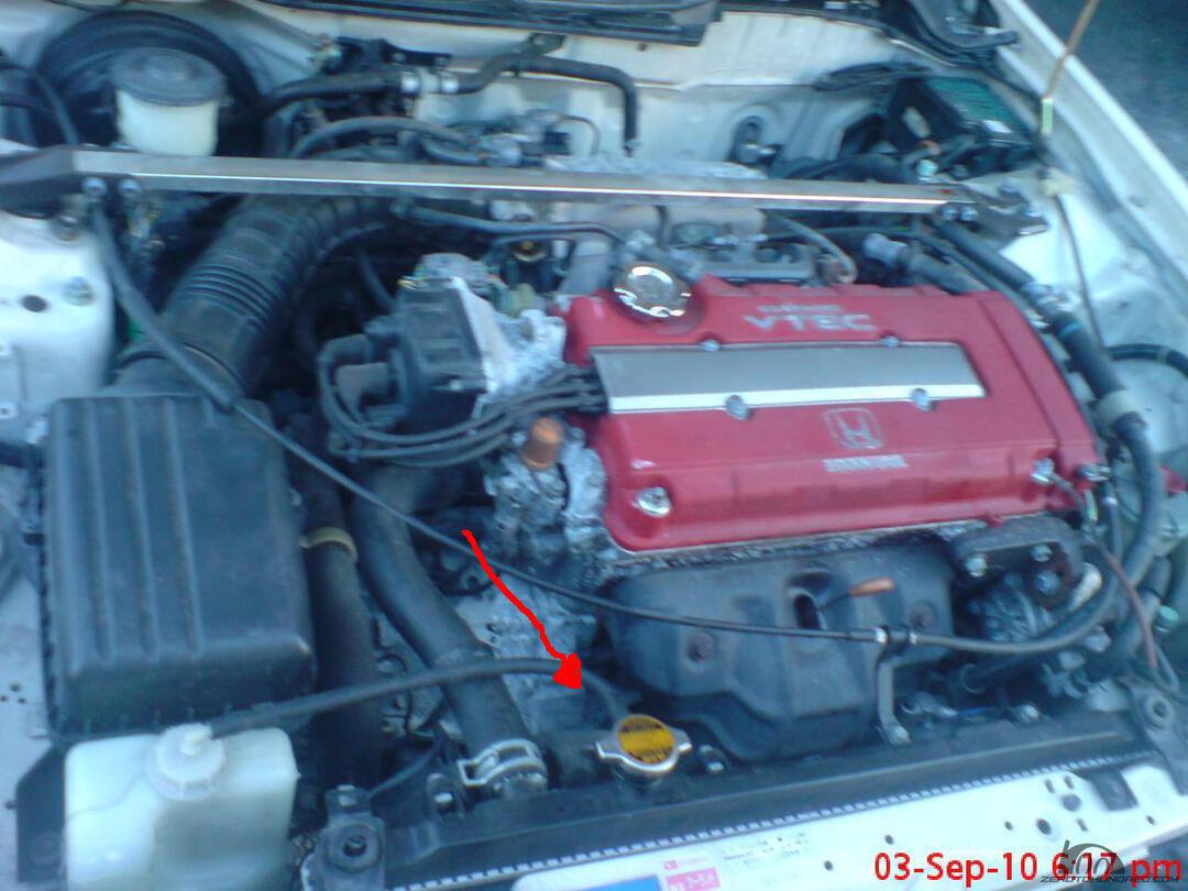

its a type r. im still very surprised that u managed to get it for 9k? anyhow, that's a good price. really really good price. even b16a also almost reaching that price already. u've got urself a bargain.
so safe to say u dont really have to worry because the halfcut comes with LSD. just find out which year the engine is made, then you can tell whether ur FD is 4.4. or 4.785..
... 9k... im actually slapping myself.. LOL..
and you've just answered your own question on how to differentiate type r and gsr. the intake is a giveaway. the gsr is the one and only engine which uses the upside down intake.
