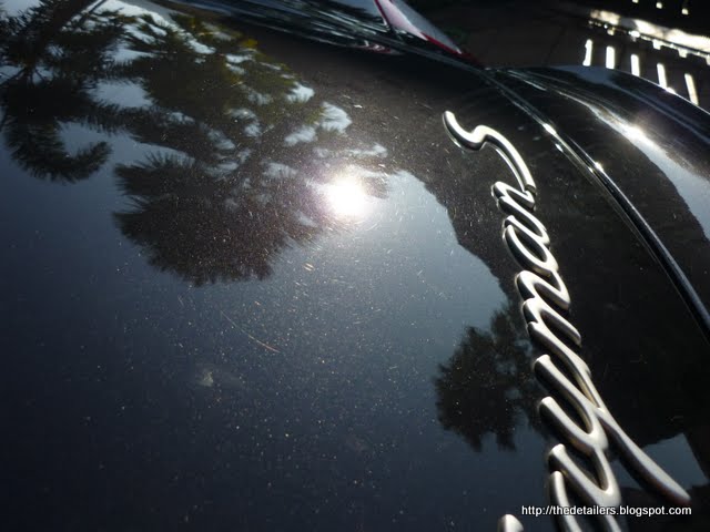

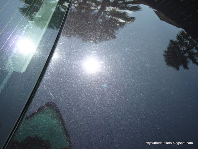

plenty of visible swirls & hologram on this Porsche

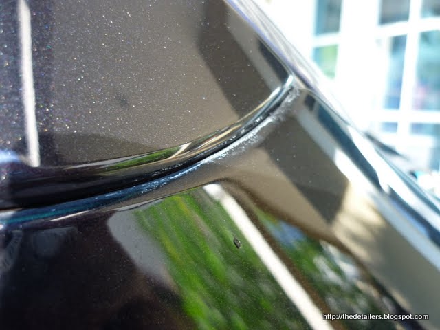

Look at the right side rear quarter - scratches
close up pic..

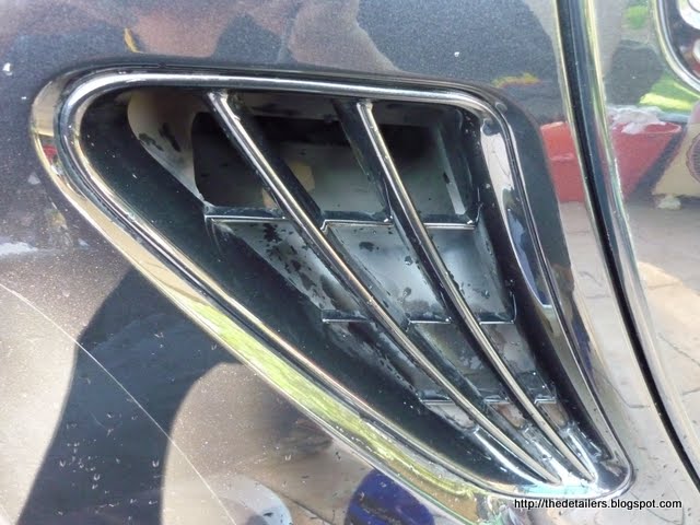

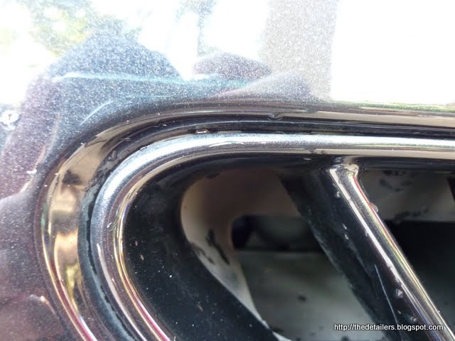

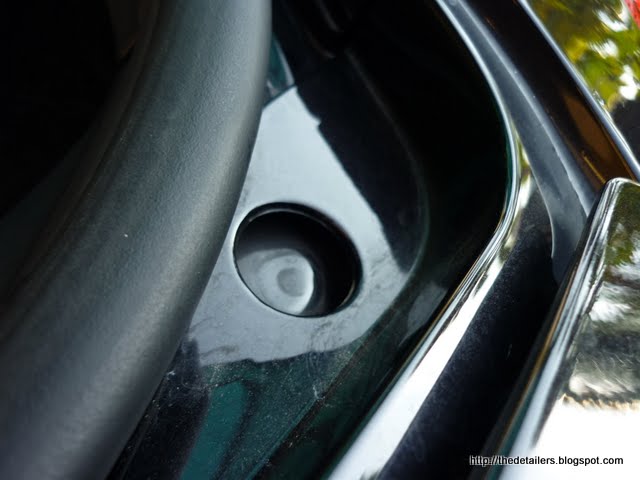

stains on side air induct..impossible for hands to reach

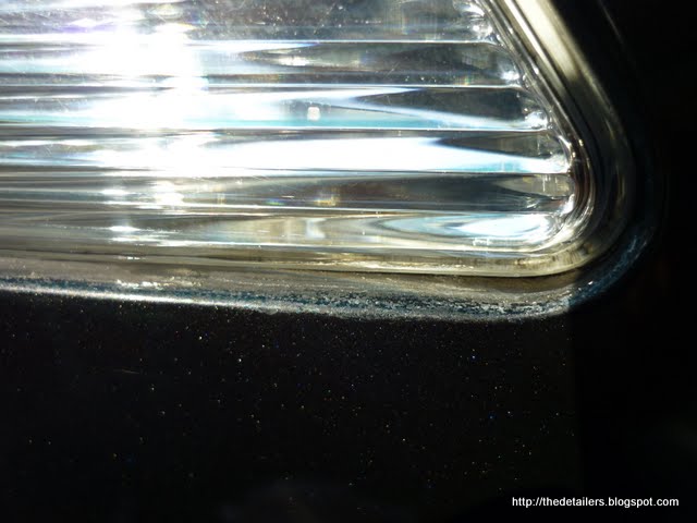

more TOGWT stains on the signal light crevice are

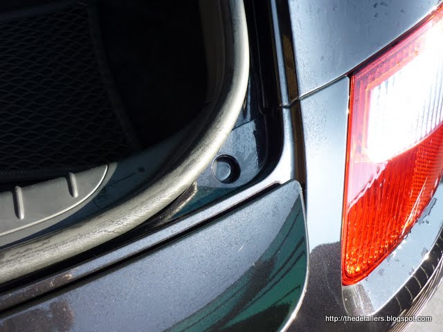

TOGWT stains in between bumper & body crevice

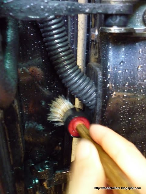

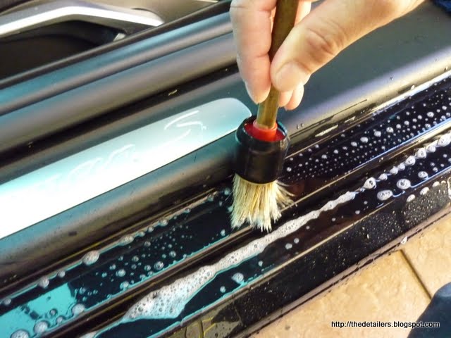

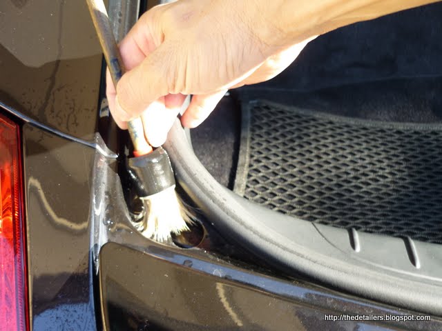

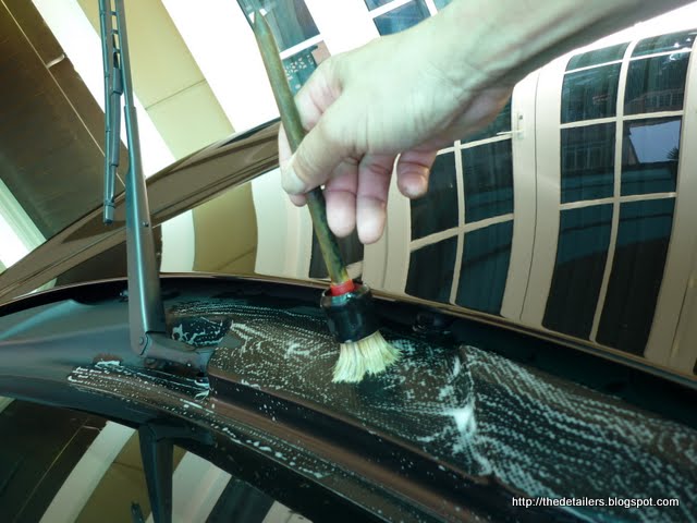

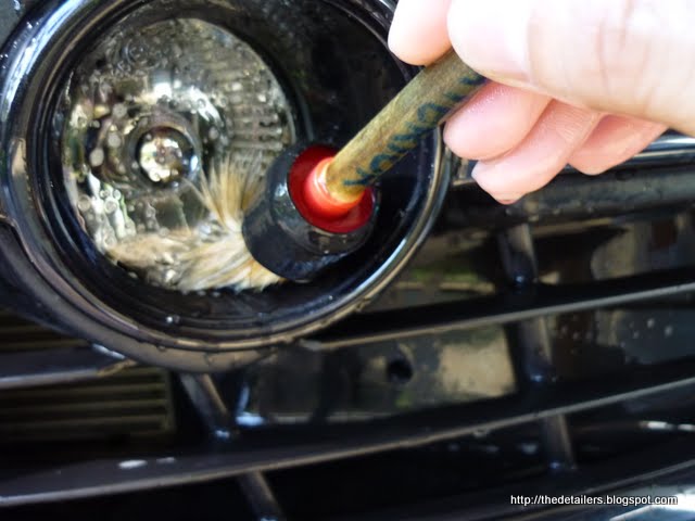

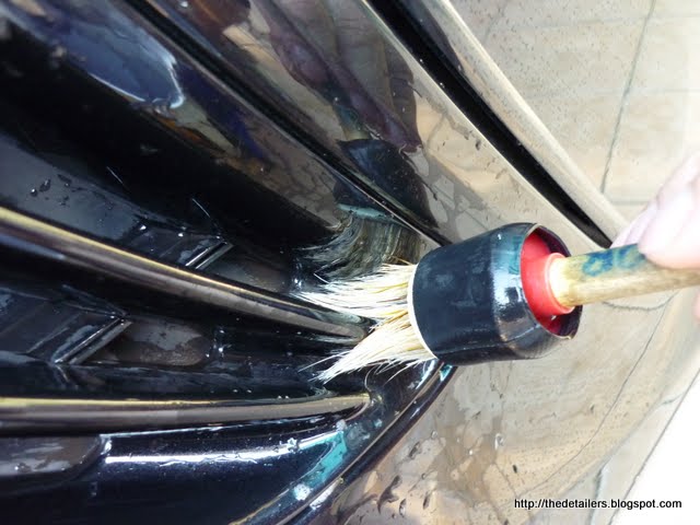

agitate Power clean & loosen with brushes

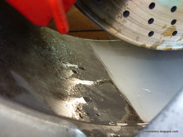

side air duct
hard to reach area - with brushes you can
more hard to reach area - but with brushes you can
front air induct area

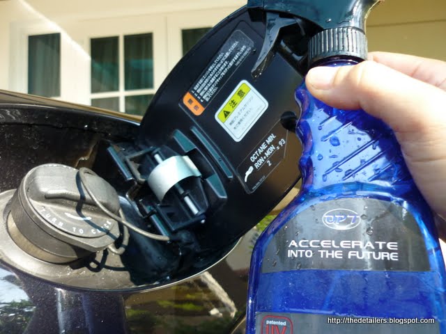

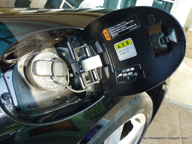

moving to petrol cap area
more brushes

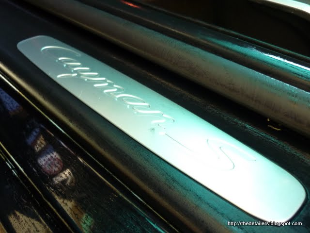

side step

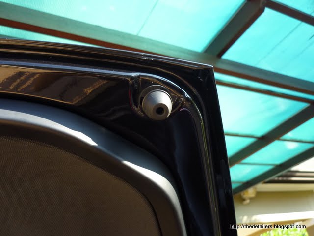

door jam
cleaning make easy esp with ONR ...as you do not require to rinse
before
ta da
& more

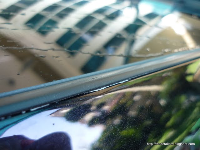

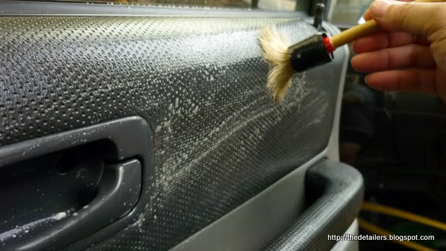

as for wax residue on door & plastic trims
recommending you ONR & light claying...slowly & steady
you remember the story of hare & tortoise
for it takes slow & steady to win the race

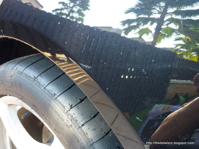

more wax residue....on rubber.... lot of stress in cleaning it..
i have seen personally some famous detailed clean it with Super degreaser .....& other shops..with kerosenes
I dont doubt it work .....but why so aggressive ....why uses more harsh cleaners
I uses POWER CLEAN & with microfibers...wiping down

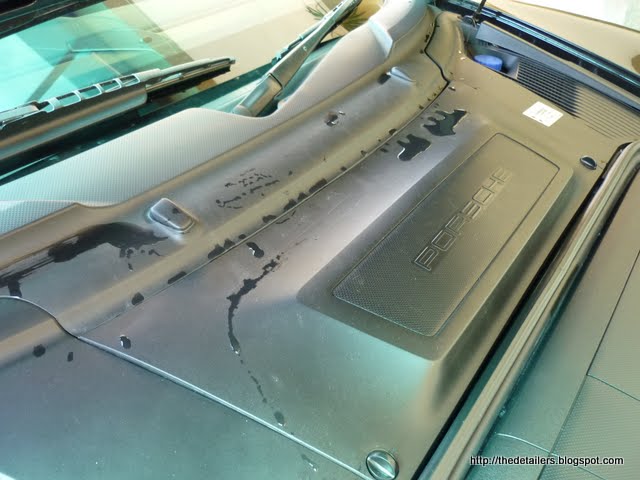

pic before
POWER CLEAN & brushes

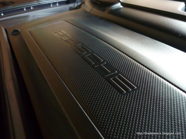

to remove previous dressing & residues ...preparing the surface
protected.....
tada

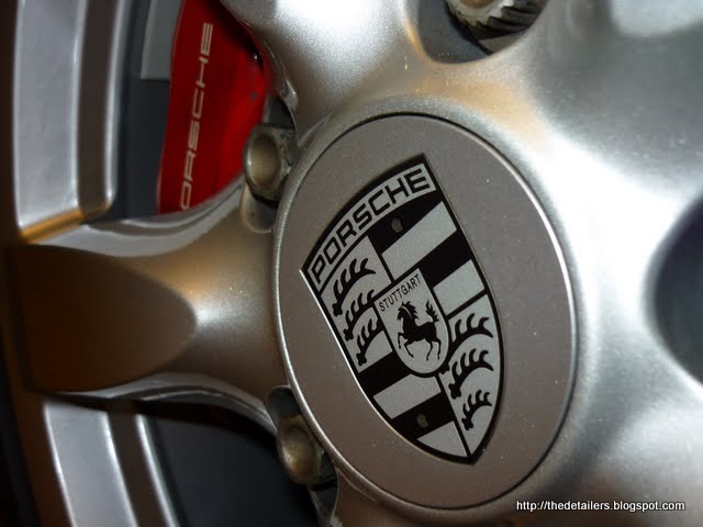

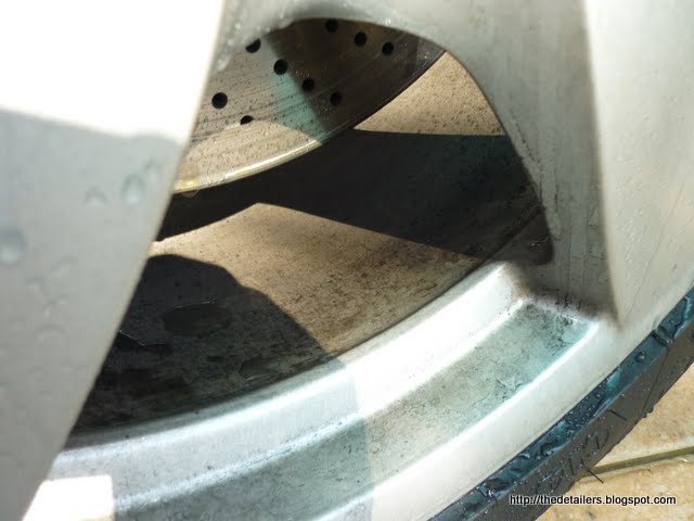

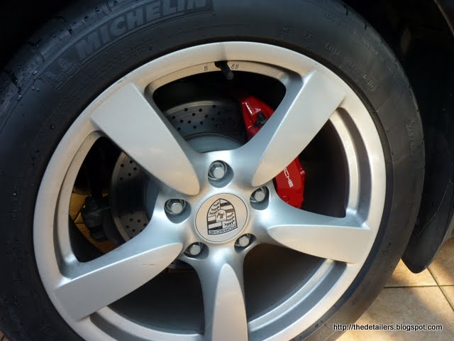

Cleaning the wheels
Quote:
major reason for damaged wheels is “instant gratification”. Many detailers just want to spray a product on, and rinse it off, and expect to have wheels that look like new. This is a main reason for detailers to choose extremely harsh wheel cleaners and to barely dilute them. They figure the stronger the chemical, the better the wheels will come out. They also spray wheel cleaners on a very hot wheel. Also, because some detailers want to rush through the job, they spray “all 4 wheels” at once and let the product sit on them. This will also quickly lead to etched and damaged wheels. You need to be smart and realize this is not a good idea and also realize that some degree of agitation is needed to release some of the brake dust
for the complete wheels detailing pls read more here http://thedetailers.blogspot.com/2010/10/wheels-detailing-simple-as-123.html
before pic
with onr....is it effective enough
judge for yourself
look at what have i collected

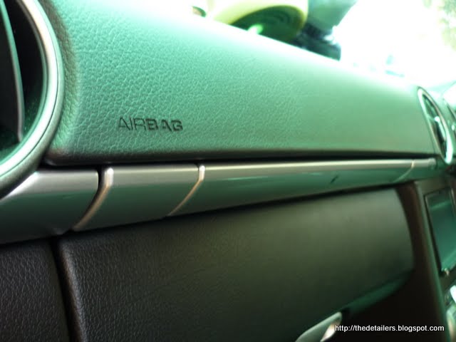

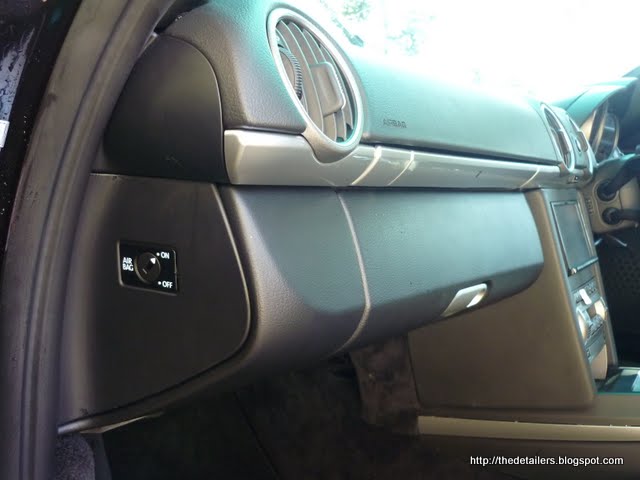

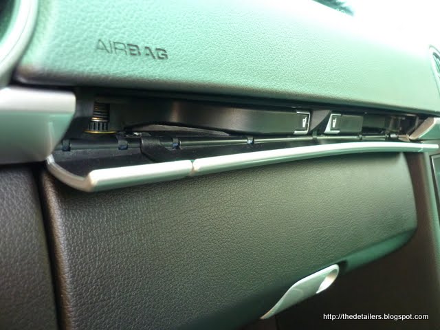

did u just notice there is switch to turn off passenger airbag
I doubt most Malaysia do not realise it is not for killing spouses but child seat..just in case

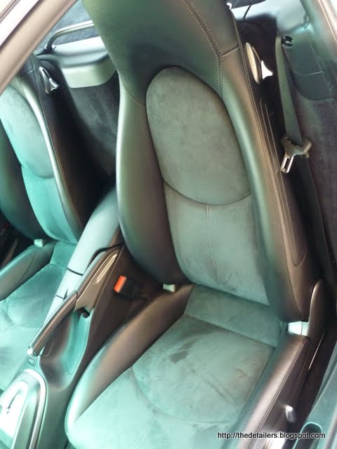

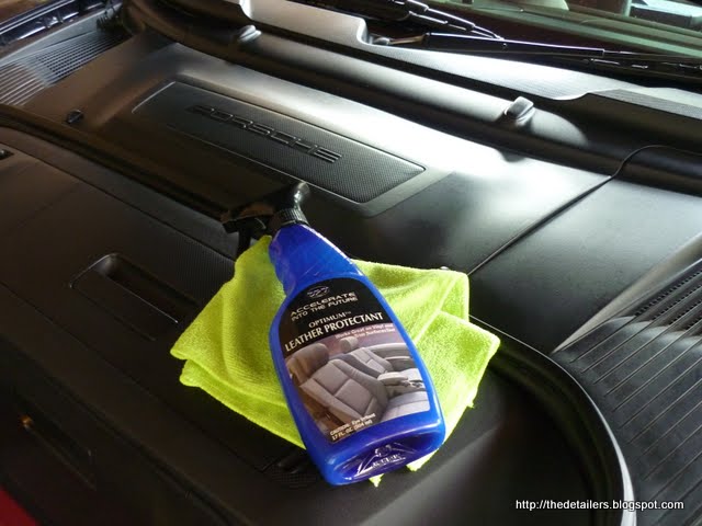

seats
wipe down & protected by leather protectant plus

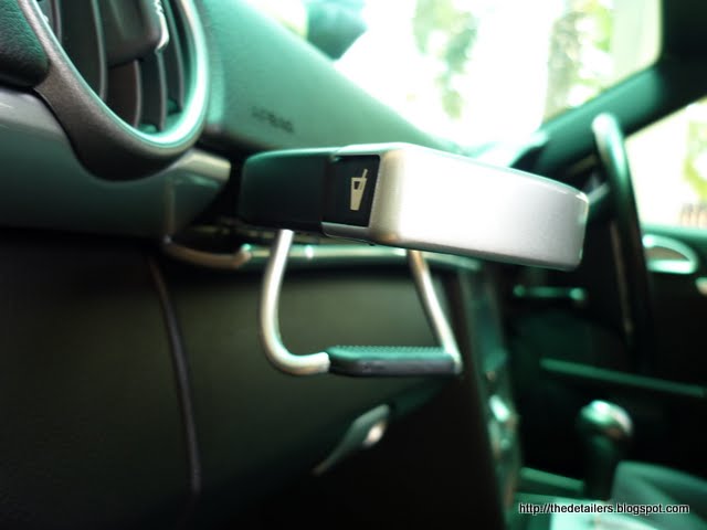

and transforming to cup holder
ta da

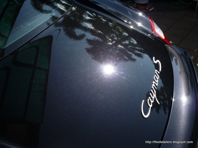

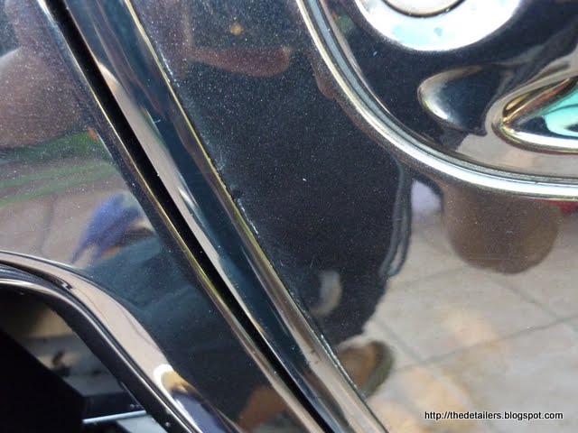

Moving on the paint work

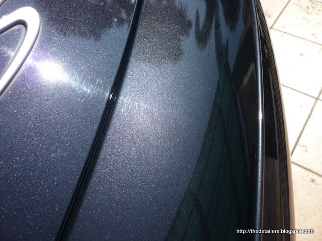

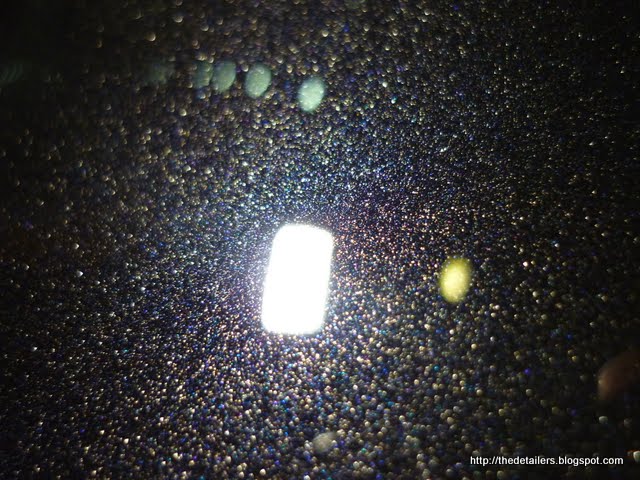

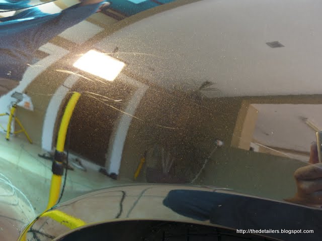

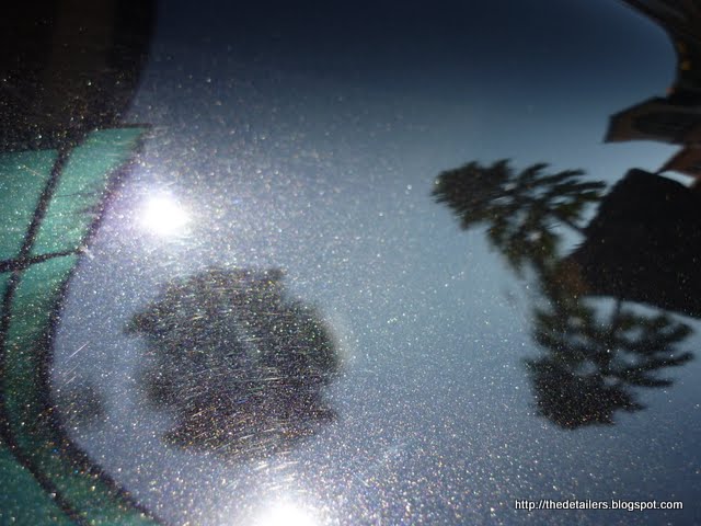

plenty of swirls from washing
more
more from A frame

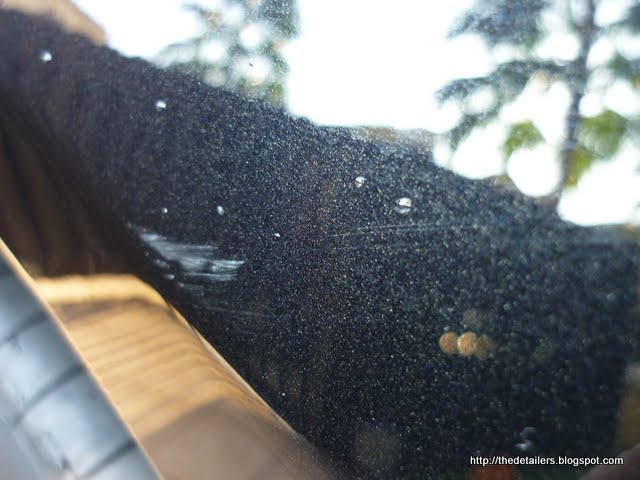

more scratches & swirls on rear right 1/4 panel
visible hologram

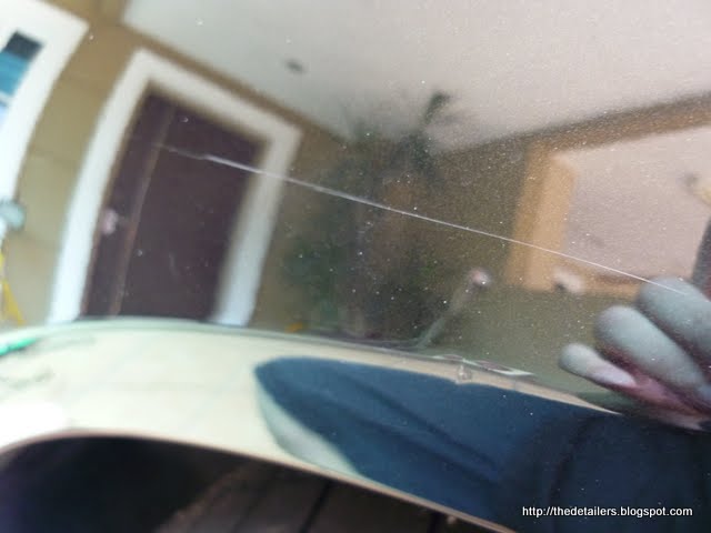

long scratch repair
more

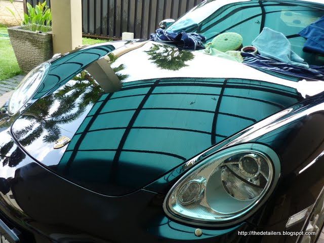

under halogen lighting

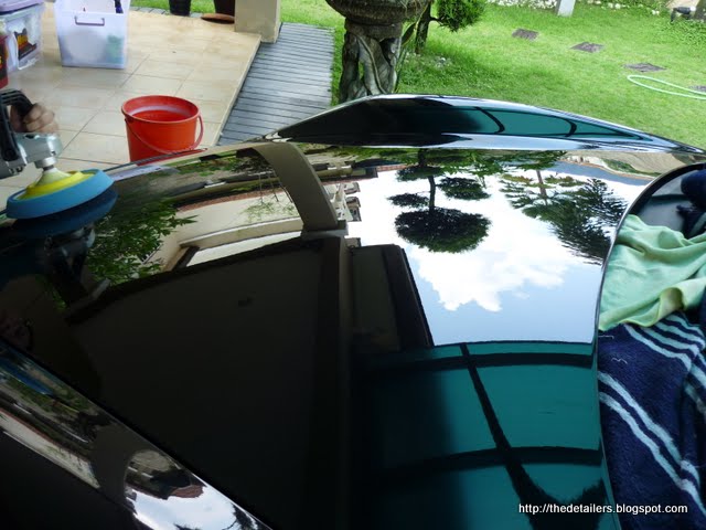

special pad flown in from US...3'' on small & curvy areas...esp on this ride

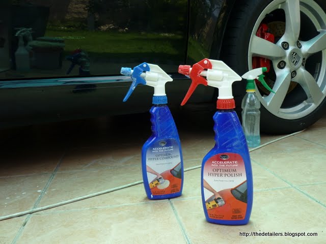

Initially I started compounding with Lake country double sided wool pad & maybe give Megs M105 a try...but due to the vinyl verandah & goes thru heat ...high temperature cakes up everything & causes more holograms...
I swap to Optimum Hyper spray polish ....excellent working time ... heat & dry resist...with this advantage.. i finish the car
Pic before
after
Compounded with OPTIMUM SPRAY HYPER COMPOUND
tada
finish
with the help of this phenomena spray polish & compound

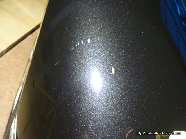

see closely again
before
after
before
after

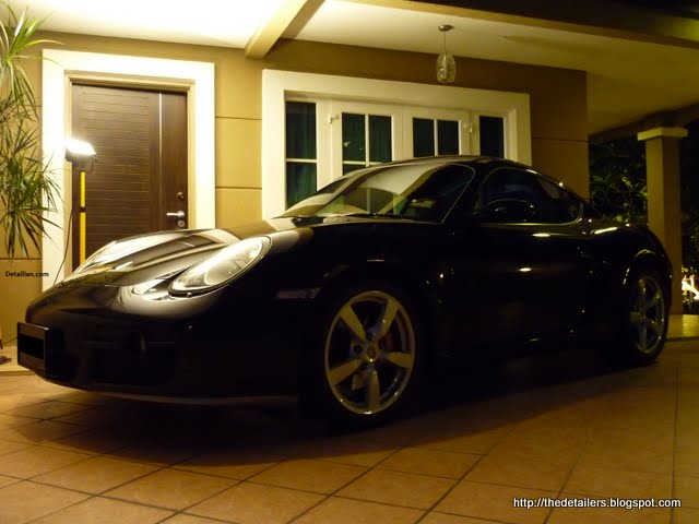

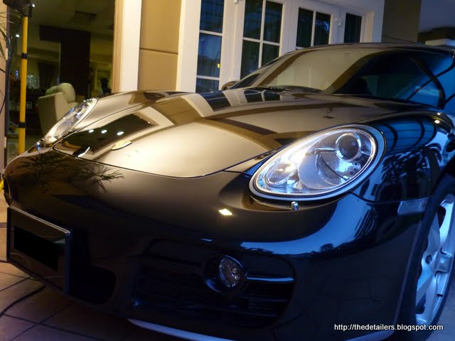

great looking paint

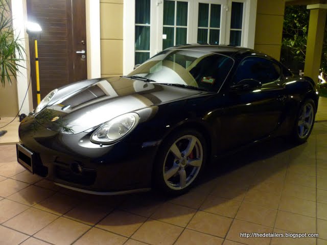

now time ...is the constant challenge...i face....dusk is coming
sunset boulevard

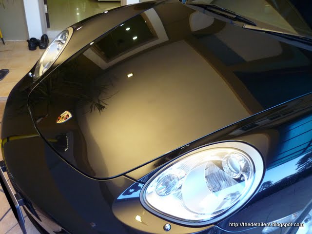

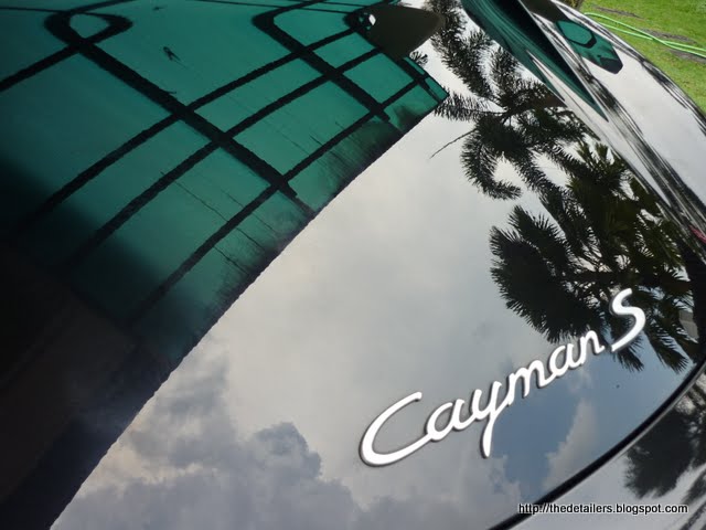

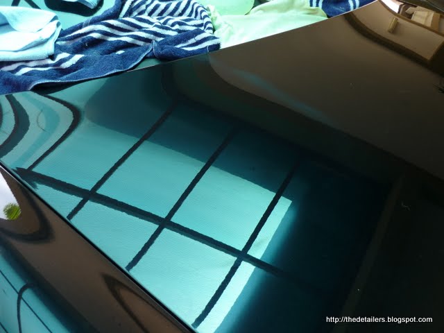

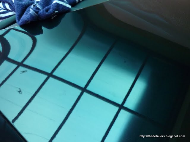

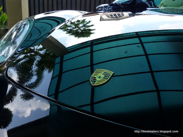

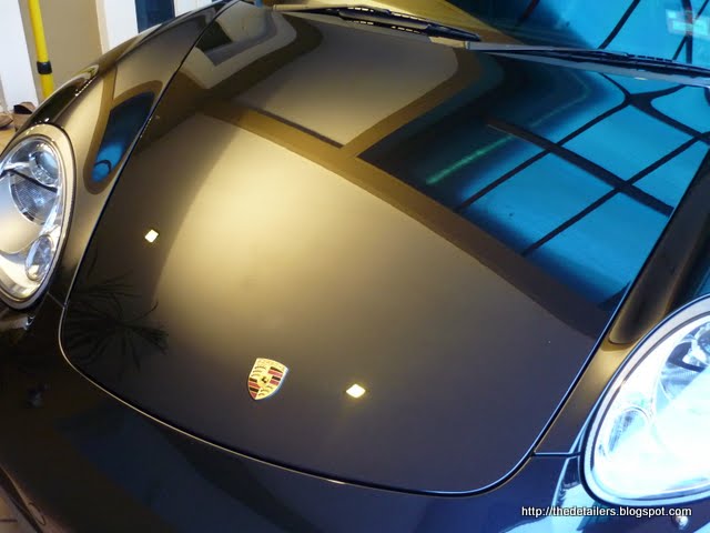

tada is the

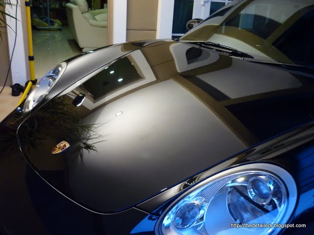

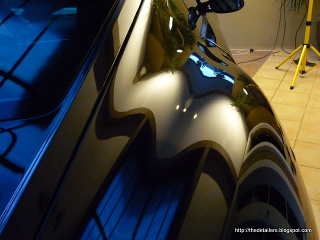

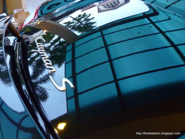

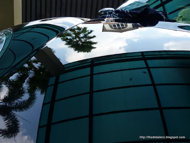

reflections of the hood

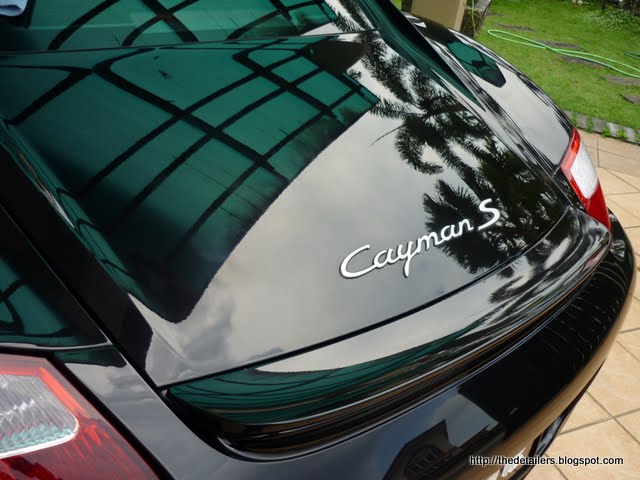

rememeber the scratches & swirls on rear right 1/4 panel
hmmmmmm
tada

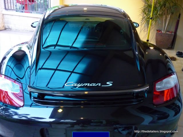

front
rear hood

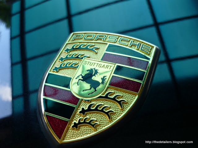

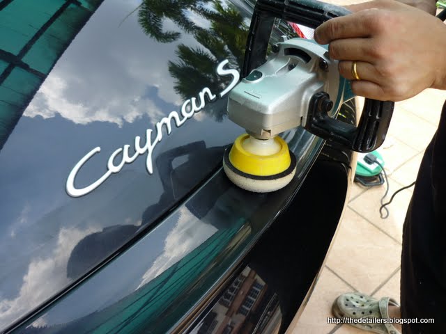

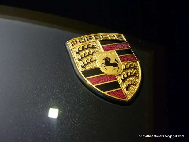

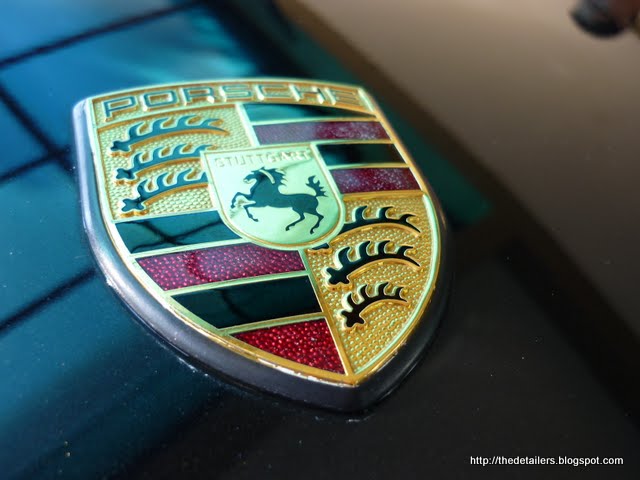

emblem pic before
now
a careful inspection carried out prior coating

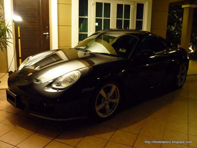

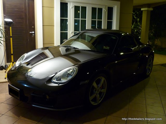

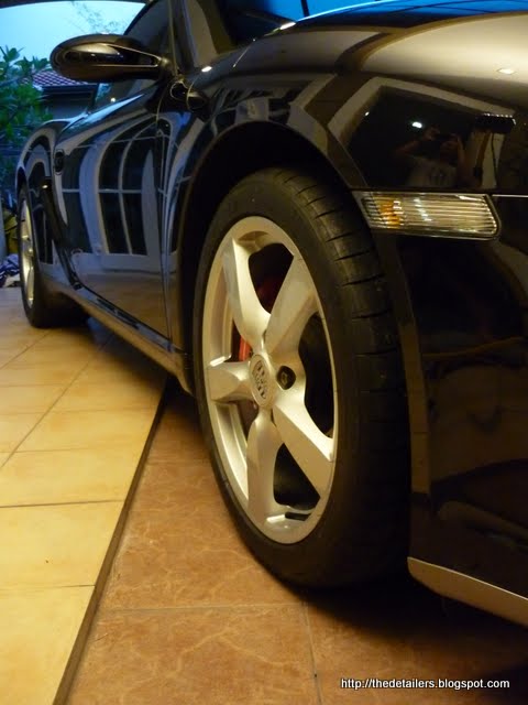

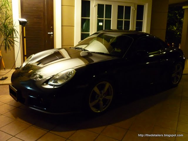

sun is down....dusk is on the way

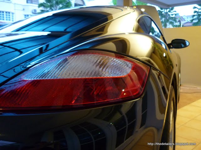

rear 1/4
side door
front
the wheels is also coated

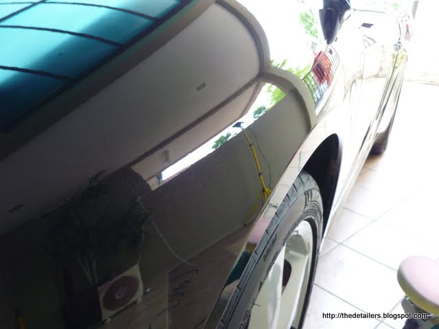

far far away ...galaxies pics
another black beauty
black stallion

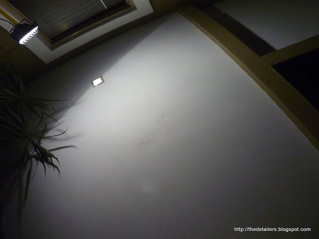

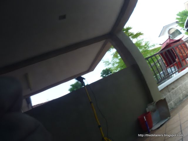

please pay attention to the dots on the centre

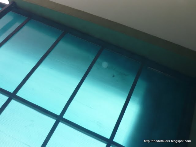

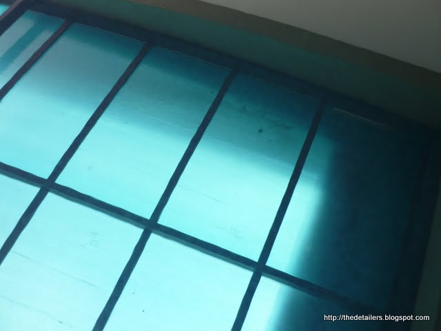

it is a reflection
of this leaking ceiling...

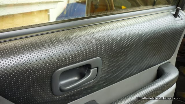

HI bro there is 2 types of vinyl or dash board products........
the usual or they car wash applications will be the tire shines, slippery & greasy ...the moment yr sleeves pass over..ta da .. dirt & oil transfers to it...this is just a dressing product..given time wear off & offer no protection against heat & sun
as the other would be...megs or leather protectant...gives u a silky finish & not oily
it does not fill holes but protect them, UV protection too....

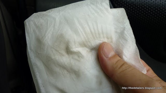

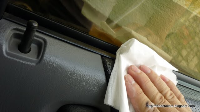

becareful what u ask for...tire shine on dash & interior no no
like these look
test ...with a tissue
ta da...you sure u want this
do u know the amount of work i need to do just to detail this....clean up the tires shines
you need to remove before you reapply any protectant on it...just imagine you only put makeup & do not remove....what happen when it build up.....cracks
My all time favorite quote!!!
"not for killing spouses but child seat..just in case" :biggrin::biggrin::biggrin:
