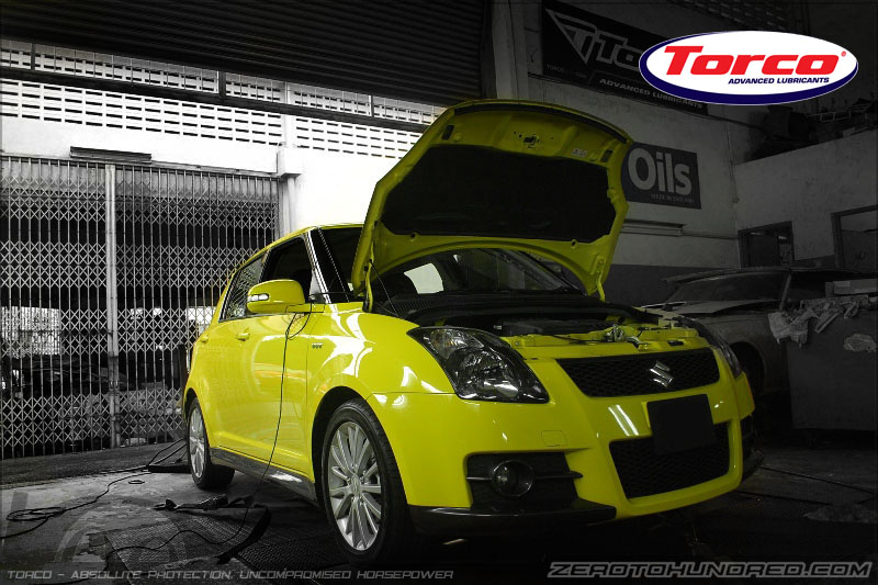

The test mule to be used was a Suzuki Swift Sport that had just scraped the six month mark off the factory floor. Luckily for us, he doesn’t baby it, driving it like he stole it. Bear in mind too that the car was bone stock, a perfect testing platform for a product review.

The method of testing would be through a driving feel as well as a dyno graph to verify any increases in power and torque. After all the liquids were inserted, the car was run for two weeks to let the oils settle in before the dyno run.
During that two weeks, the driver of the Swift Sport mentioned the improvement in driving feel of the car. He did mention that the acceleration felt nippier and was more willing to rev to the redline. In short, the engine felt lighter and revved faster. Although he did add that the difference wasn’t significant, it’s important to note that it was there nonetheless and testament to the product’s claims.
While a butt dyno may not be the scientific method of proving power gains, the person that knows the car best would be the owner as he drives it everyday and is the most intimate with it. Plus, the changes were noticeable almost immediately after the change. Lighter and faster revving, quicker acceleration and smoother gear shifts could be felt by the driver. Not only does it make the car perform better, it makes the driving experience more enriching and a pleasure to push the car even more, especially with the knowledge that the Torco products are protecting the engine at the same time.
On the gear shifting side, the driver acknowledged the smoother shifting compared to before. Perhaps the most significant improvement was to the fuel consumption. Whereas before on a full tank of petrol the car only managed 380km before the warning light did its thing, the light was now nowhere to be seen even though the mileage had surpassed the 420km. This was verified again by running two full tanks and the results were similar. Logic would dictate that the reduced friction lead to less power loss, thus enabling more power to reach the wheels and less fuel needed to produce the power required.
After the two weeks had passed, the dyno run was on to get a more precise idea of the improvements. A few dyno runs later, the results were out. The before run charted a wheel-horsepower rating of 111.08hp while the after run netted a minute improvement of 112.81hp. Now although the difference is minute, bear in mind that all this is just from a change of motor and gearbox oil.
The big difference though was in the torque. The before run saw 131.33Nm of torque at the wheels while the after run had a more pleasant improvement to 134.54Nm. not only did the torque jump up, the improvement was immense in the 2,500rpm to 3,400rpm range, as can be seen from the dyno graph.
Simply put, the improvements came courtesy of the reduced friction that reduced energy loss throughout the drivetrain, freeing up more power. Torco has a full range of products and will surely have one to suit your vehicle. So if you’re up for destroying the devil in the detail, make sure your shafts are properly lubricated to enhance performance, and yes, that pun was intended.
