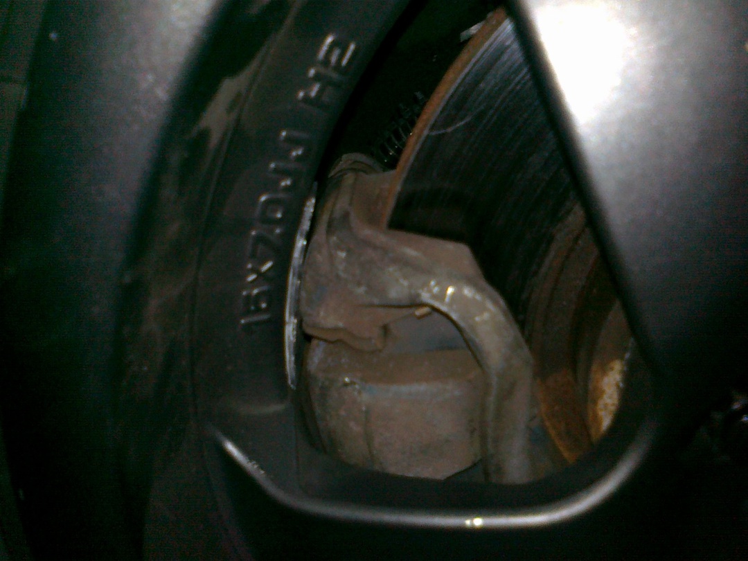

bro...this is my 15" rim with BB1 brakes
the clearance is already pretty minimal due to the calipers... my balancing weights scraped the calipers and now all come off already...
so if u go bigger rotors... i dont think its gonna be ideal
but then this also depends on the interior design of the rims...some 15" rims can clear the BB1 rotors with no issues

I bought BB4 disc & caliper for RM350 including drill 4 hole PCD 100. Then I mod the bracket + installation everything RM180. Total cost RM530.
Please refer attached photo. Even my rim offset is 35+ but compare to your photos, looks like your gap is bigger than me. Haha. You can see clearly that the balancing marble (not sure I call it correct or not), you need to hit it until it thin & then can ngam ngam clear the rotor...

LOL...yeah man...damn close.... think ill try to take a pic of the same angle as urs (with regards to the balancing weights) and post up...see how much clearance i actually get...coz i oso never actually seen it before heheheh

I think maybe my rim design cost it too near....Haha...Anyway, I go high speed, d balancing marbles also wont come out. So just leave it...Lolz...:biggrin:

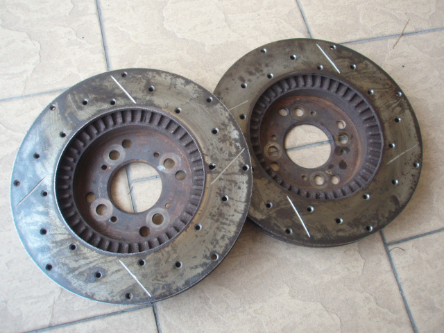

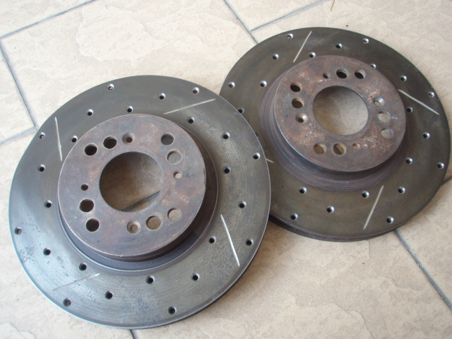

crossdrilled and slotted (inside n outside) disc rotor only....already modded to pcd 100 so is PNP to any 100 or 114.3 hole knuckle....rm200

but was the crossdrilled/slotted manufactured that way or was it modded?
