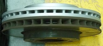

This disc/rotor is from which car? Can mod into EG? Anyone can help?

ok....so after searching the marketplace...found some crossdrilled and slotted rotors from improve meant for the FD2. its 282mm...just need to re-drill to appropriate PCD to make sure it fits...
he also said for me to come over his place....bukak my rotor and compare for size n offset to ensure can ngam....if ngam... kasi beli :D
