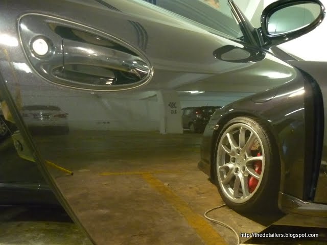

left side passenger door

Paint correction -

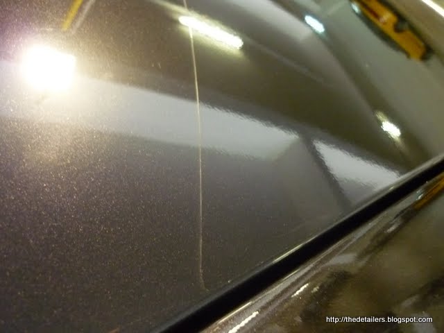

pics taken 3 WEEKS ago- plenty of swirls & some hologramming existed....sign of
under noon day sun
left quater back
pics before - swrils from improper washing
after trying a numerous product... it seems that Megs M105 with Lake country CCS cutting pad suits the correction..as there is lots of RIDs under the swirls...awaiting to surface when the swirls is eliminating

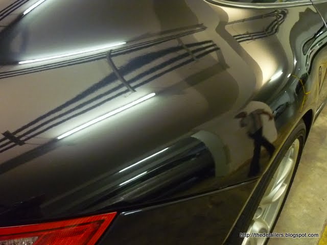

utimate shine at last, my detailing adventure will be very dull without my buddy Seech...

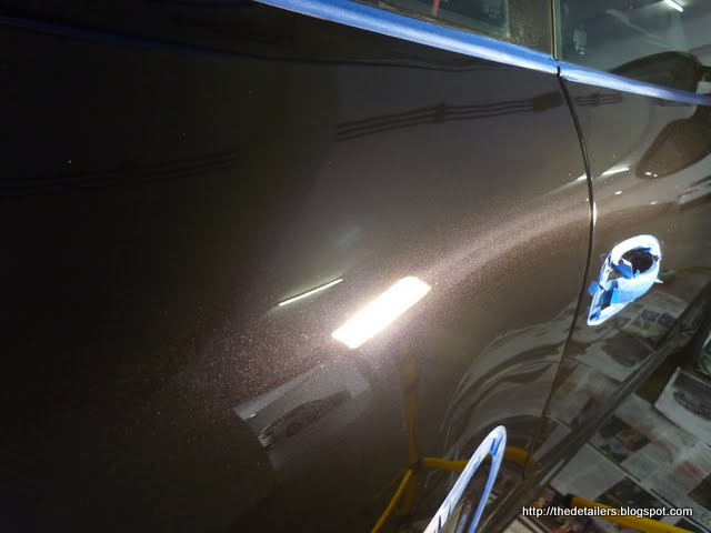

1st 50/50 % area tape & set for product testing
the 50/50 % pics before & after
finishing pics

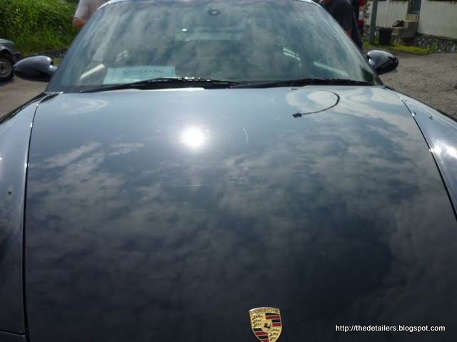

now let me remind you what u might have miss or might over looked
almost everybody glances thru thought it is just a shot...but this is a reflection shot...thanks to my buddy patience & passion.....
ta da
mirror shine again
