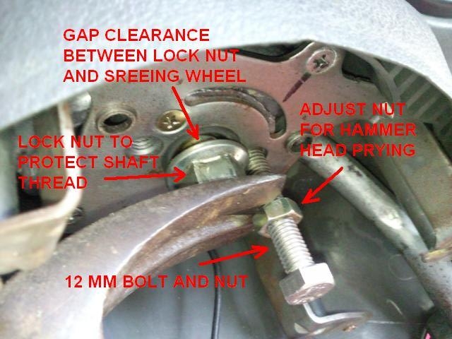

Ok. I got it removed by using a RM2 bolt&nut.
Another picture
Looks very unprofessional...
But hey, who cares right?
Thanks.
diy is fun..hahah
limited tool can bring up briliant idea
and cheap..and succes
Thanks.
Very ingenious.

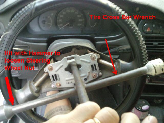

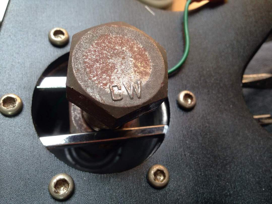

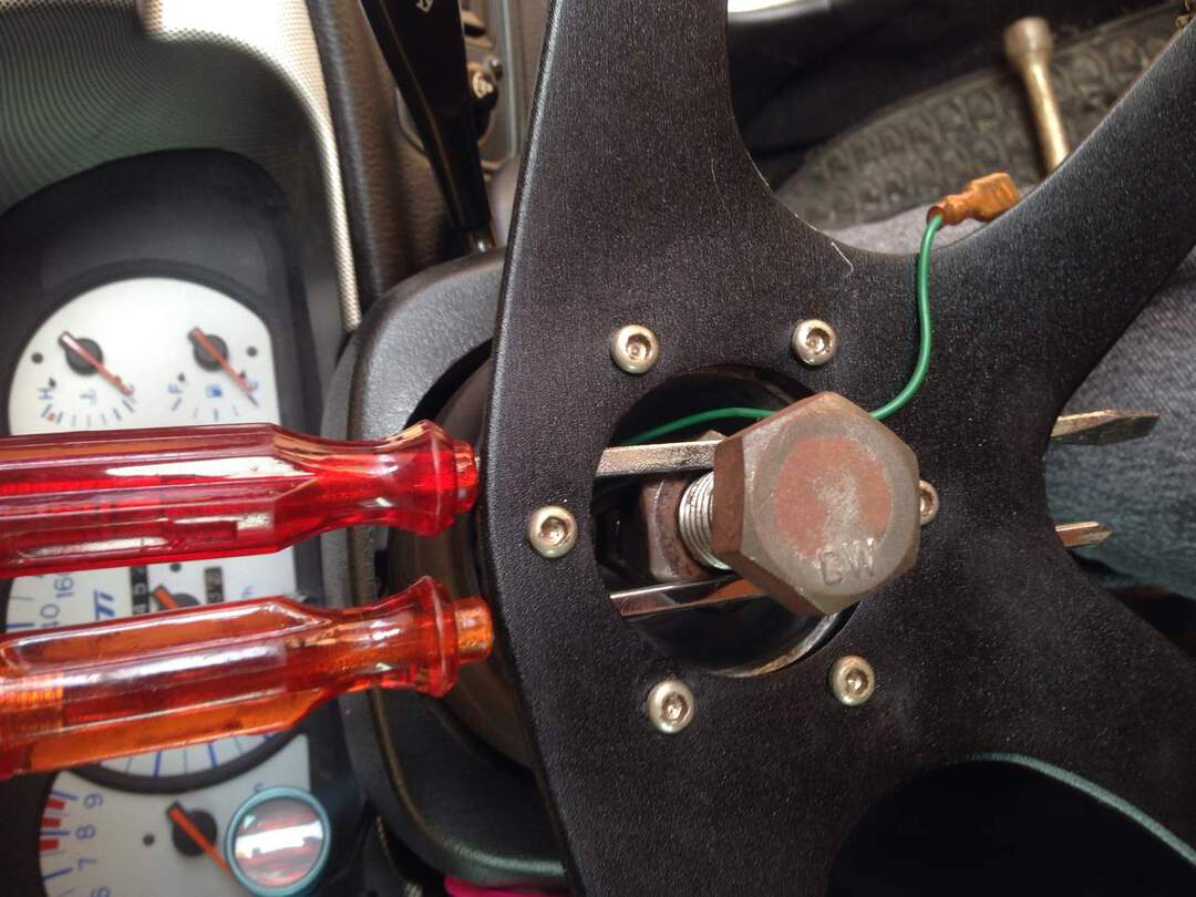

I thought I'm the only one with weird way of removing steering wheel that worked. Here, how I do it.:rofl:

then there is advices about using proper tools....
Do not misuse tools. Use the wrong tool could cause accident, and likely to damage the equipment.
Imagine using the wrong size socket.....and one would strip-out the nut, making it harder or impposible to loosened.
