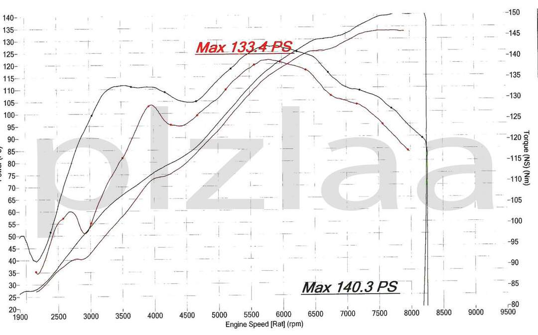

Already called the tuner & he said he will use back SAE calculation which means just convert from STD to SAE reading & print out for me. No need dyno/tuning again... Is it correct that no need to dyno/tuning again? :confused:
Or need to ask them to dyno/tuning again with SAE reading?
Normally what is the difference reading between SAE & STD? Alot ???
The before E-Manage is tune by 1st tuner but after install E-Manage, it's a 2nd tuner to dyno/tune the car as 1st tuner is not working on that day. Previously 1st tuner already told me that he can't promise how many HP can increase after E-Manage install as he told me my engine stock without E-Manage, already had a good reading HP & he say might gain 1 or 2 HP only...But of coz after tune car will be smoother...:hmmmm:

I agree that we don't expect much on this E-Manage for stock BT engine but it is good to have it as to fine tune our BT engine where after we mod piping, extractor, air-filter & etc.......Because our stock ECU is meant for everything stock but once we have do the above upgrades, we should have a piggyback management to fine tune our car.
My concern is not to gain 5-10Hp & 5-10 torque for my engine after install E-Manage. What I want is to make my car smoother with correct Air/Fuel tuning.
FYI, I have tested out that after install E-Manage, my petrol save abit where last time when I use on highway, cost me 16sen/km but now with E-Manage at highway, cost me 14sen plus/km. So in long term, it still save me & my car is in correct Air/Fuel....
Anyway, thanks for all bros on the comment & sharing info. Really appreciate it & I got to learn something extra new today. I will be going back to the tuner this weekend to print out the dyno graph with SAE reading. Will not expect much but at least same HP & Torque with my previous 1st graph or additional 1-2HP & 1-2 Torque.....

Hi guys,
I have got the SAE reading already. Please refer newly attached dyno graph.
1st graph - Before E-Manage
2nd graph - After E-Manage
3rd graph - Comparison between 1st & 2nd graph
Anyone here using E-Manage want to share their dyno graph as well? :biggrin:
Generally HP increase by 1.53 & torque increase by 0.11 only. Overall, still satisfy with it...

Now this is correct comparison, :-)
Looks like you gain a lot on the mid range than at the peak,are you running on 'trumpets' before e-manage?
Ya. I gain alot on the mid range where is good feel.
I run on internal IMEC Japan trumpets & use back my plenum with HKS air-filter before E-Manage as well...:biggrin:

RM1.4k can fund towards high cam? I don't think so bro. Not only high cam. There is other need to include as well. Money of coz I have alot but not enough till millionare..Lolz...Joking only...
By the way, for your info, I have timing harness & it can run injector function as well. So no need injector harness..It really save abit on petrol. This is my 3rd E-Manage I have been using. Previously I used E-Manage on my RB20DET & SuperCharger as well.....:biggrin:
