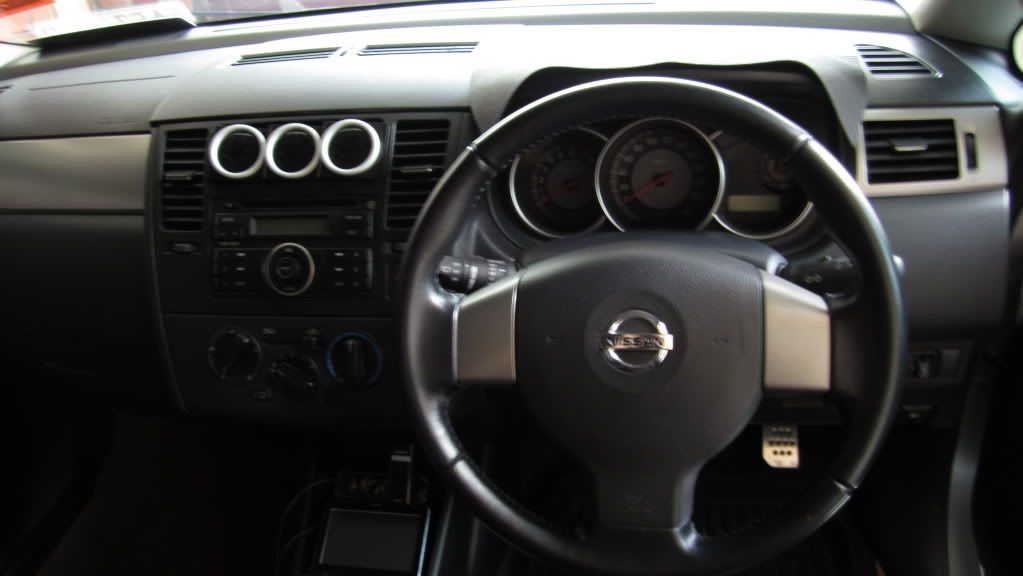

bkf8660
May 25, 2010
143
8
hi newbie Nissan may i know what car are u driving
i am driving a HR 16 Small modification done like you too:
i never change the exhaust set because was fully imported blast || Impul
same like you-adjustable lighten cam-pully
-air filter remain oem, just change to K&N.
-Hot Inazma VS
Im probably NA at the moment but now i am wishing to have ECU which i can gain few Horse and save few buck when i upgraded to Supercharger by still using the same ECU
many was recommended me like E-manage,Piggyback,Unichip,Shadow E-drive Throttle Controller..i am so confused which to choose
Please advice sifu !!
MKMD428
Aug 21, 2005
876
190
5,043
johore
you latio was just introduced at nismoclub rite...? hehehe
e-drive throttle cntrler is not a piggyback.
