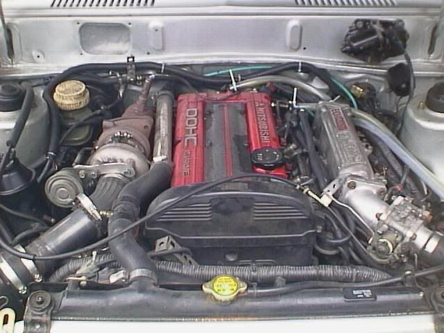

evo3
1,500 RPM
Jul 2, 2004
1,794
24
Visit site
maybe a 1JZ also can. :)
The old supra JZA axle can be used.
sigma with VR4.

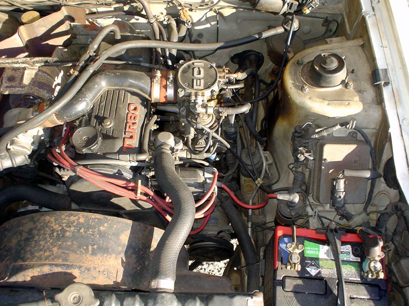

bro if u want to plug n play i have 1 halfcut sigma turbo GT 1982 bro....2liter turbo ECI single cam... half cut come 1 car includding roof,4door,rear bonet...includding kastam form n AP...price RM5.5k....if u like u can call me 0142998807....or come to my garage to see 1st....loc/kuantan....u can plug n play bro....no neet to mod driveshaft....:biggrin: n 1 more it come with rear axel.....all item ORI sigma turbo gt 2liter...year1982......

Evo 3,
Is that you show the engine is the galant sigma bay?? Look nice fit in it...But how about the modification..I it many thing to modified..??
evo3
1,500 RPM
Jul 2, 2004
1,794
24
Visit site
yup..that a sigma engine bay. belong to one my friend. you just need to modify the tapak, position of the turbo and the water pipe. ;p Battery relocated to the back. GB if not mistaken, use back sigma cos i don quite remember already.
