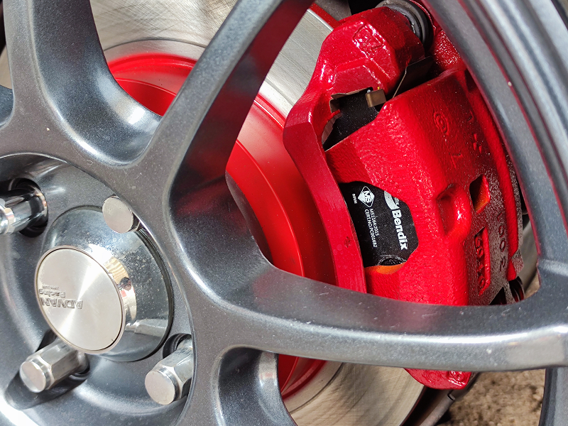

my 4G15 also experienced that extreme at one of the front caliper... removed it and service it... problem gone... since it was removed... decided to replace the brake pad and give the caliper a fresh red paint. hahaha....
