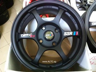

Bro, any recomendation for a good place to get a set of nice wheels ?
saw this on the net, very niceee

according to tyre shop, most faith branded rim r made in china now aday, it will easily crack....
as me, i 'll buy advanti, lenso.....or ......japan oem rim.....safety purpose.
Agree, better buy well known brands even if made in Taiwan/Philipine like Advanti, Lenso, Enkei (non Japan). Those are good value for money if you cannot afford Japan/Euro rims. Remember to buy the lightest one you can afford, don't just focus on the looks.
