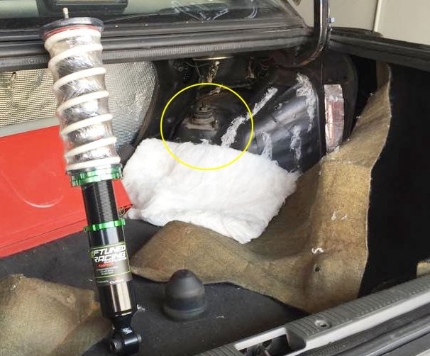

My ISC front no problem can adjust, but the rear will require and extender, which sadly i did not get.

The top part of the coilovers at the rear is covered by a square metal. Need to get the extender and only then it can adjust as the extender will pass a small hole.
Damn difficult to explain :D

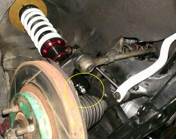

Please note that inverted monotube's settings knob is located below. They said there were 20 clicks but when I counted, it was 23 clicks on all 4 shocks.

So all adjustment in wheel fender....
If all adjust at wheel fender then good. But remove rear seats to adjust? Damn! So troublesome.
Like that get the KW adjustables also better. Can use remote control to adjust iinm or was it only to adjust the ride height I think. Not the damping rate.
No idea how to read the graph too.
Electronic one, all control by button on dash.....:driver:

Mine is fairly easy to access
That's better if can adjust within the car itself.
Front because it's inverted looks like this ..
Have to turn the wheel to reach it.
I think pro & cons, if it is difficult to access to adjust the damping rate, then at least u have no worries of people meddling with your damping rate.
