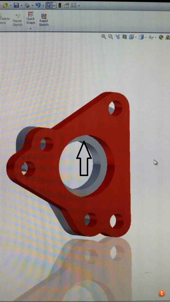

Hahah yeah. Having some headaches trying to center the output hole on the manifold and the input side of the turbo. Bolt overlapping. Well decided to weld in a new adapter of the manifold to make it permanently take td04.
On the wastegate the problem seem to be worse than i tot.. the gate is on the internal side of the housing and the output side is shared with the exhaust.. nothing i cant settle tho, ill be fillinf in the cavity and remachine the housing so the exhaust and wastegate side is isolated. On the EWG its gonna be mounted real close to the rad..

ok. TD04-09 does share the actuator gate with exhaust. that's why u need to weld a plate to devide them into two row. then makesure the surface of the mouth then is machined flat so no gap when install the dumppipe flange.. a plate 5 mm or above shud be enuff for the devider plate. get a mild steel plate and weld it using oxy-gas weld since the housing may be cast iron. u may use MIG but makesure u not how to pre-heated the housing 1st..

what u can do to the actuator valve is install a bracket holder to hold the gate to always open. dont weld it permanently as it cant be use in future if u want to sell it. the devider plate is a no brainer as people can use back actuator n custom dumppipe if there's no EWG.

Im planning to make it a fixed thing.. hehe.. no intentions to sell the turbo anyways.. probably buy a spare to keep rather. thanks for the pointer anyway..

u need to put some spacer between those 2 plate...atleast around 1"-2" for easier access to flange bolt/nut

Pomen gtr. Im reversing the turbo bolts so it mounts from the front side rather than the rear side.. making it easier to remove in the future.
ohh.. so u r using countersunk bolts for the turbo flange? better to drill the stock exhaust holes to fit the same size as the TD04 hole..

Err no actually.. im going to weld the bracket dead to the original manifold.

oh ok.. u suggest the flange hole to be drill the same so the gas flow would be better.. see attached image.. that hole would be better u u drill to same size.. just my opinion..

Oh haha.. the difference is for welding.. im asking the welder to fill up the difference and i will grind it down to size. The grey part is actually the manifold end while the red piece is the add on adapter.
This is what im trying to achieve.. :)
