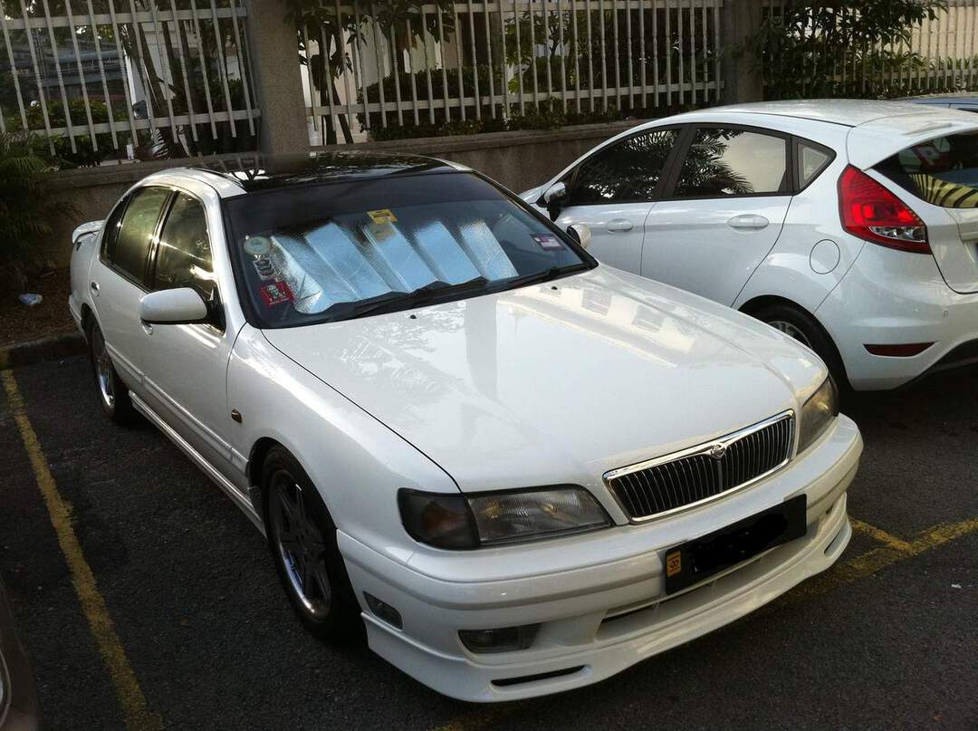

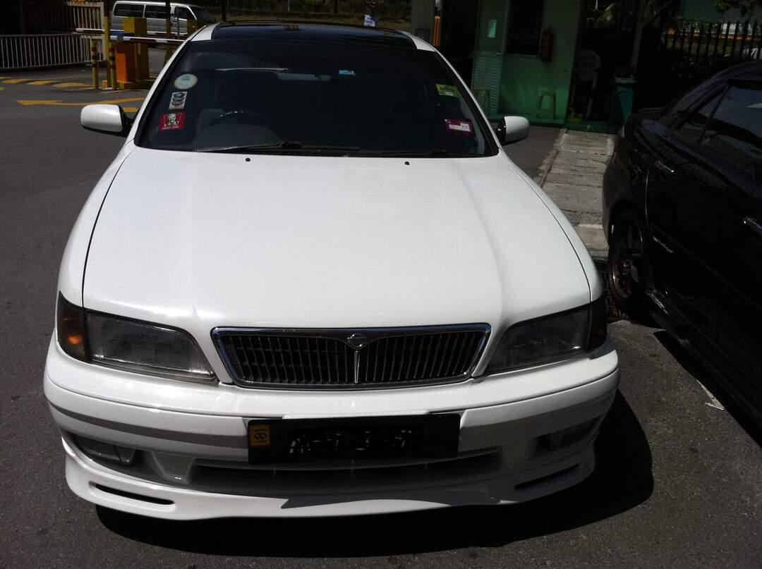

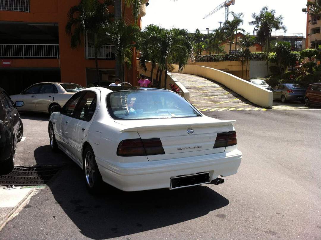

Bro Xtec , Hi ! long time no hear from you ! Reason to sell my ride is becoz of limited parking lots available. Seen my car recently? It wears a crystal white paint now with hids 4300k.
What about you ? Still in S'pore of Penang ? Still having the A32?:smokin:
hi bro yap , same.. ya selling soon also...look for anothers VQ engine car
