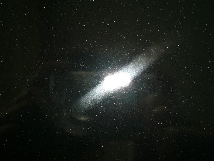

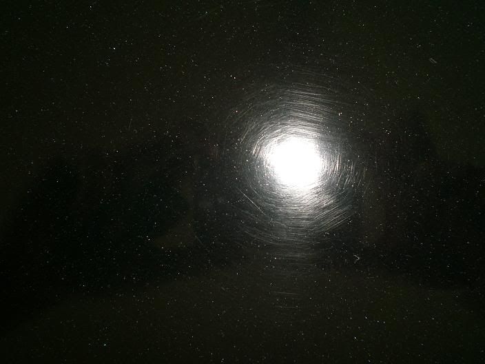

I have a black car with a lot of swirl marks because of bad washing habits. Yo should use the 2 bucket method to prevent dirt from getting lodged in your wash mitt. More on 2 bucket method here. If you don't have 2 buckets, you should wash your car from top to bottom.
Next, to remove the swirls, try Meguiar's ColourX. It worked fine for me. Check out this thread for the results. I applied ColourX by hand and it can even remove some deep scratches.
BEFORE
AFTER
For black cars, to bring out the shine and achieve the "wet-look", use Meguiar's NXT Tech Wax.
Post some pics of your paintwork here! A month old car shouldn't look too bad! Take the pics under bright sunlight for best effect.
