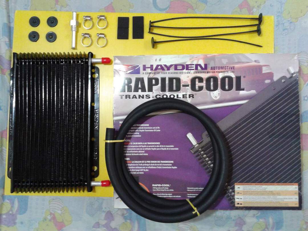

Oh I see! Thanks for the reply! In that case I will install a Hayden ATF oil cooler for the car.

Yeah! I have inspected the 2 gearbox hoses and I intend to install an additional ATF cooler to reduce the ATF oil temperature further.
