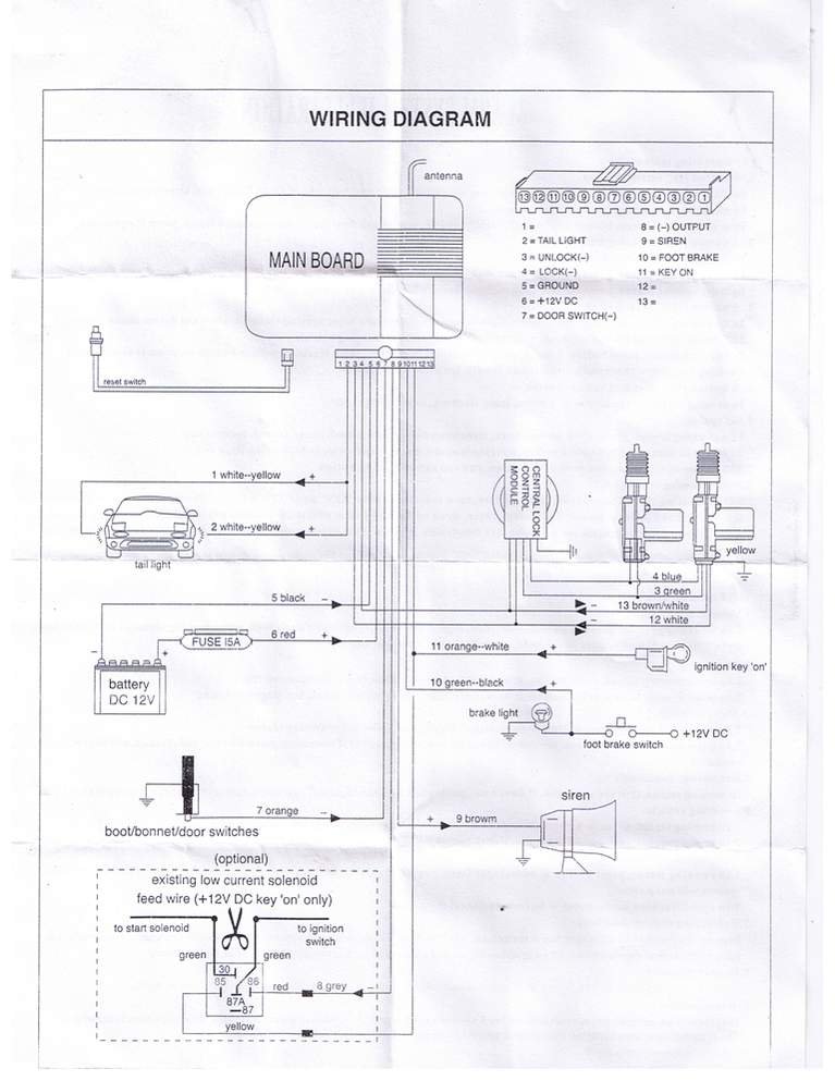

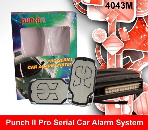

Hi.. I wan to install alarm system for my yr95 kancil.
This is the alarm that I want to fix in.
Punch II Pro Serial Car Alarm System 4043M
Main Features:
1. Lock & Unlock
2. Door Open Signal Lamp
3. Reset Button
4. Auto Rearming
5. Leaning Code
6. Mute Arming
7. Impact Memory
8.Brake Lock
And I uploaded the wiring diagram.
I heard that there is the alarm things on the passenger side box bottom. I tried to see but nothing. Just a few unplug wire over there.
The wire is not one by one. Few a them are connected to the white things and another few connect to the other white thing(you can see it often, that they connect all wire together) . And thats it.
There was an alarm system installed before. So maybe they took it off and i think mostly the wire was for the alarm(maybe).
So how to start ? Is it difficult ? Pls help. Thanks
