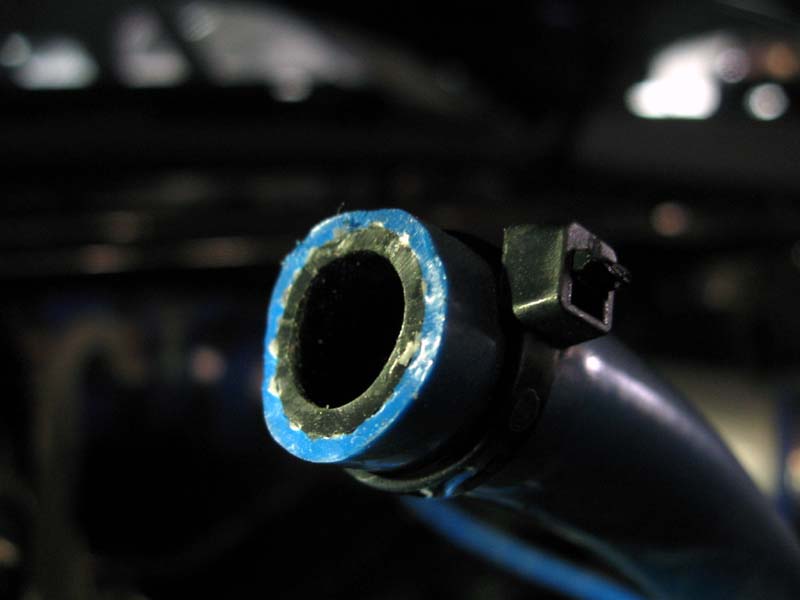

Suitable hose to use for OCT?
Tried to use the gas hose but failed tremendously. hahaha. Now using fuel hose which is more durable but unfortunately it only came in black color. Where can get the transparent type but in heat resistant form?
Thanks all.
I've been using gas hose for more the a year already...
Blue color summore...it never fails me...
the blue color one, got 1 layer of black in the inner hose, in the middle got another layer of kind of cloth mesh...i think...and the outer layer...the blue color still soft hose...

chinozie ;
That was the same hose i used previously. The hose melted & it collapsed under vacuumed pressure. Btw, where did you get it?

There are 2 types of steel braided hose.
The Teflon internal n the rubber internal. The Teflon is high heat resistance n high pressure. They are not expandable. U can't even have a sudden bend or it'll break. Normally used in industrial hydraulic application. In automotive, normally clutch hose, brake line, turbo oil feed.
The rubber type is more flexible and expendable. They can handle heat up to a certain extend. Pressure wise, so so. Not recommended to be used for hydraulic application... But low presssure like oil pump, oct, fuel line still no problem. Even pro rs brake lines are using rubber type.
U can try using rubber type.
If u want the clear type hose, u can try the industrial water pipe. I think the material is PU. But there are steel rings coiles like spring along the pipe. Comes in various size and can be found in hydraulic shop.
