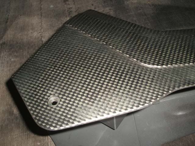

i here now trying to get a carbon fiber like texture paints diy style. obviously its not going to be perfect
here are the things needed
GOLD/bronze/silver spray paints ( i still experimenting)
black color paints
and a stensil

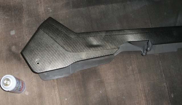

heres few picsture

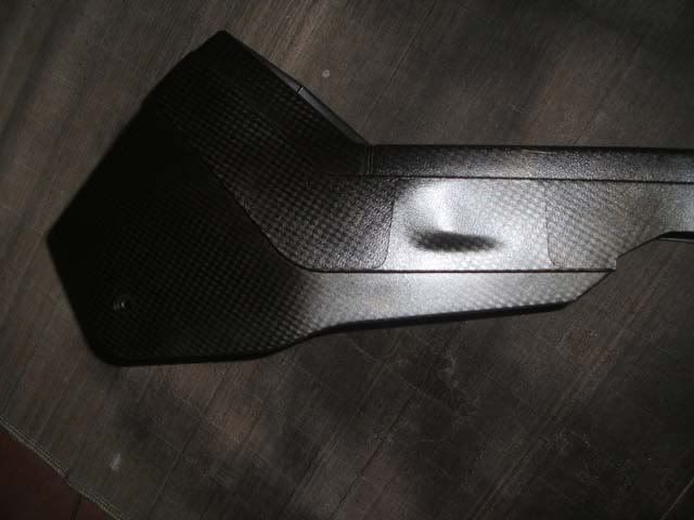

my 1st attempt (not beautiful at all) T,T
close ups
and the finish product with glossty look
generally, i spray black as base.. then.. place stensil over and think layer of texture and finish with a thin layer of back follow by clear coat for glossy finish!!
hapyp DIY! if you ever tried this , please post ur result and suggestion.
lets perfect this and make spray paint fella that charge few hundreds for such simple concept no business! hahahahahah

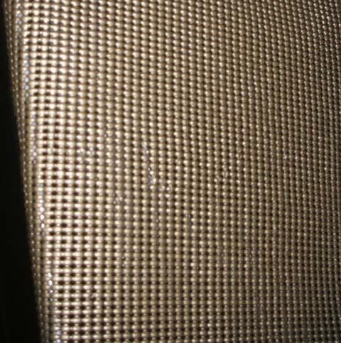

i wanted to ask for the same Q,issit the anti slip mat tht u r using for the stensils?curious:shocked:
mokomoko
Feb 20, 2006
895
154
1,543
Yes its anti-slip mats. you could try out different patterns and show us how it looks like too. Happy DIYing :_:
unknown1x
Sep 26, 2006
369
2
wow! thx for answering for me.. and yes! its anti-slip mat.. can buy from carefour.. big big piece at 12 bucks i think.. the bigger the easier.. in case you have big surface to cover.. ^^
