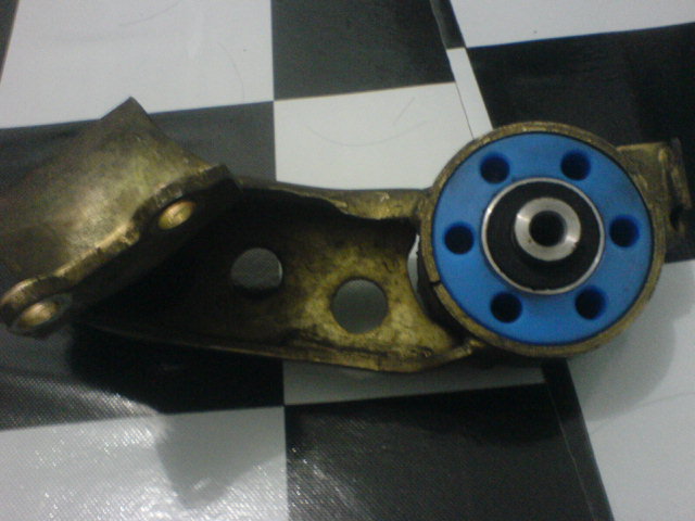

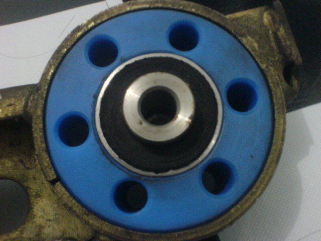

i'm using for my otr car and still using it...okeh what:proud:....no need to install all the mounting with it...just at the back...bcoz dont want engine lean backwards when hi rev...minimize power lose...feel better and like changed to new clutch..
btw its NOT PU but mine is TEFLON.:biggrin:
dnt use this material unless u plan to crack ur chassis for a daily drive
Darth
May 10, 2005
368
2
3,018
Selangor
MYTH ka tyco?:hmmmm: been used it almost 2 years...never cracked the chasis lor....if you see clearly the pic..you will notice sumthing.....like i said in the 1st places...i'm using it for the back mounting only....peace....
