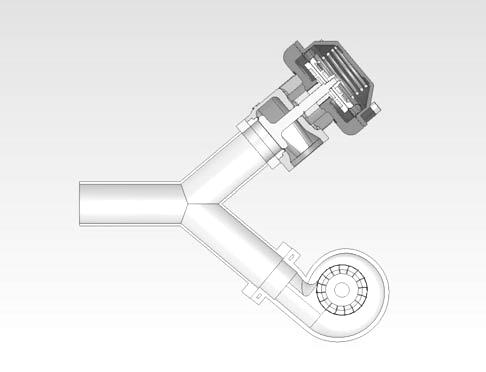

1. Symmetric V-Shaped to Turbine & External Wastegate
Internal wastegate/actuator will release air at a maximum of how much boost pressure? 0.8, 1.2 bar? An option to increase boost levels is to use external wastegate. Symmetric V-shaped improves exhaust air flow to external wastegate, and promotes more accurate functioning of the wastegate.

1) tubular exhaust manifold. Stainless steel seems nice, but how many fabricator uses thick elbow and chamfer the edges of the tubes before they weld in order to increase the strength of the joint. It's also not easy to achieve equal length unless u extend length of the single pipe before the flange.
2) It's not easy to achieve Y joint on wastegate and turbo. Unless u wanna locate ur wastegate down which is hardly visible. And also, it's hard to reach when modification, maintenance is necessary.
