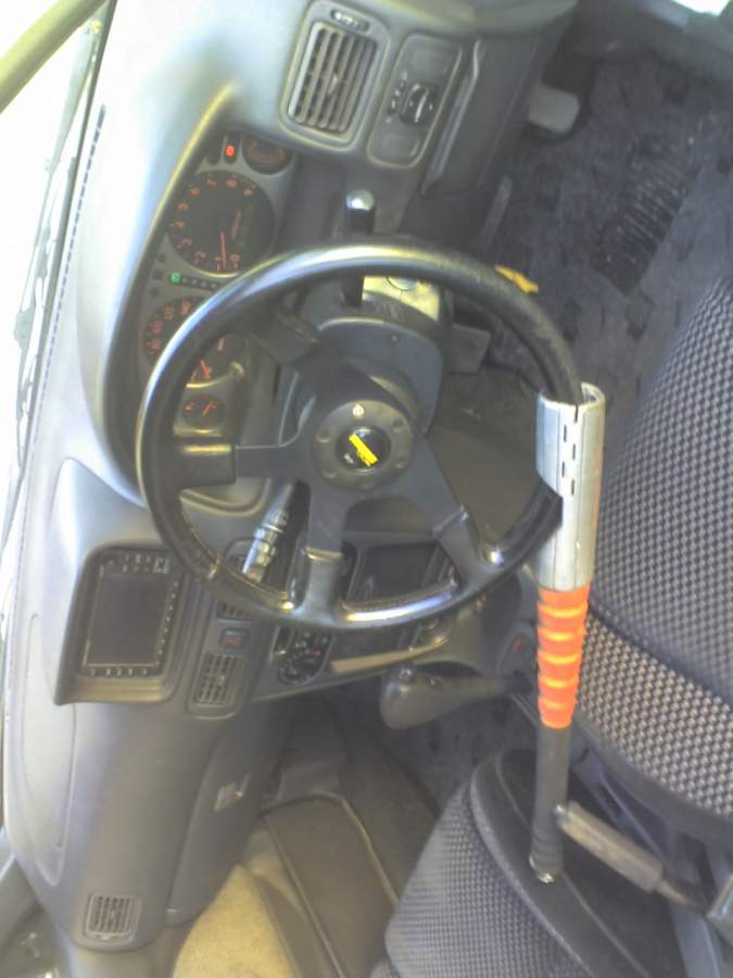

My car Se limited dont have Honk after conv. to BT engine(Ae111).
My mechanic suggest to put ae101 streng honk switch n wiring.
Any guyz n sifos got experience in this please advise me.
As I know Ae101 n Ae111 is different in honk wiring. Also the material of wire also different.
Help me please..my car dont have HONK...

are you using ori dashboard or the bt dash?
coz steering column n steering is different, bt is using airbag type, which is using spinner for both airbag n steering horn, while ae92 is non airbag type which uses copper contact point for horn...
I'm using Bt dashboard.
What you says same with my mechanic told.
Bt using spinner.
meanwhile I'm plug momo stereng.
How to connect momo horn wiring to spinner(like ribbon wire)

u r using ae111 4 door dash, very nice looking coz got double din head unit scope.. f u can find the ori japan boss kit from h/c shop that is nor airbag, then solve ur problem already... not big deal lar.. since u r using the bt dash n the steering column..

sorry ya typing error, what i mean is to get a boss kit from halfcut that is for airbag type, then will solve your problem already..

So I need to find boss kit for airbeg sterenglah?
Can use any brand or boss kit 4 toyota only?
