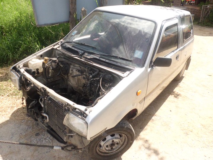

I just bought a 1992 Mira (Thai-built) 3 cylinder carb with a blown motor. I will be buying a second-hand EFI motor from Japan for it. The shop that will be installing my next motor has warned me to stay away from Turbo motors. Apparently the parts can be expensive and hard to find here in Thailand but I will ask the motor shop if they stock all the parts for these motors as the shop is massive!
I was previously thinking about the JB-DET as it seems to have the most power at lowest RPM, or maybe the EF-RL.
Now I am thinking more about the JB-EL because it has no Turbo. From my research, it has the most power for a non-Turbo (43kW). Is that correct? Is it known to be a good dependable engine, or can anyone suggest one that may be better for me?
Thanks for any info as I am a noob to Daihatsus but I'm getting excited already!
