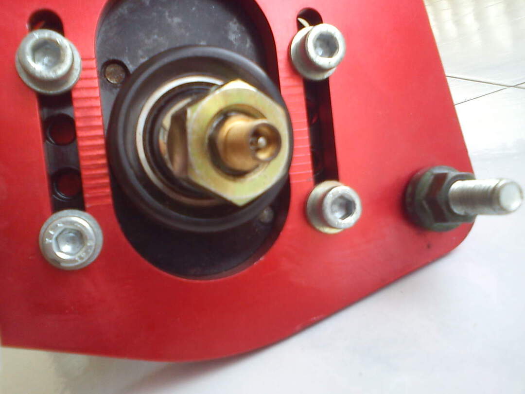

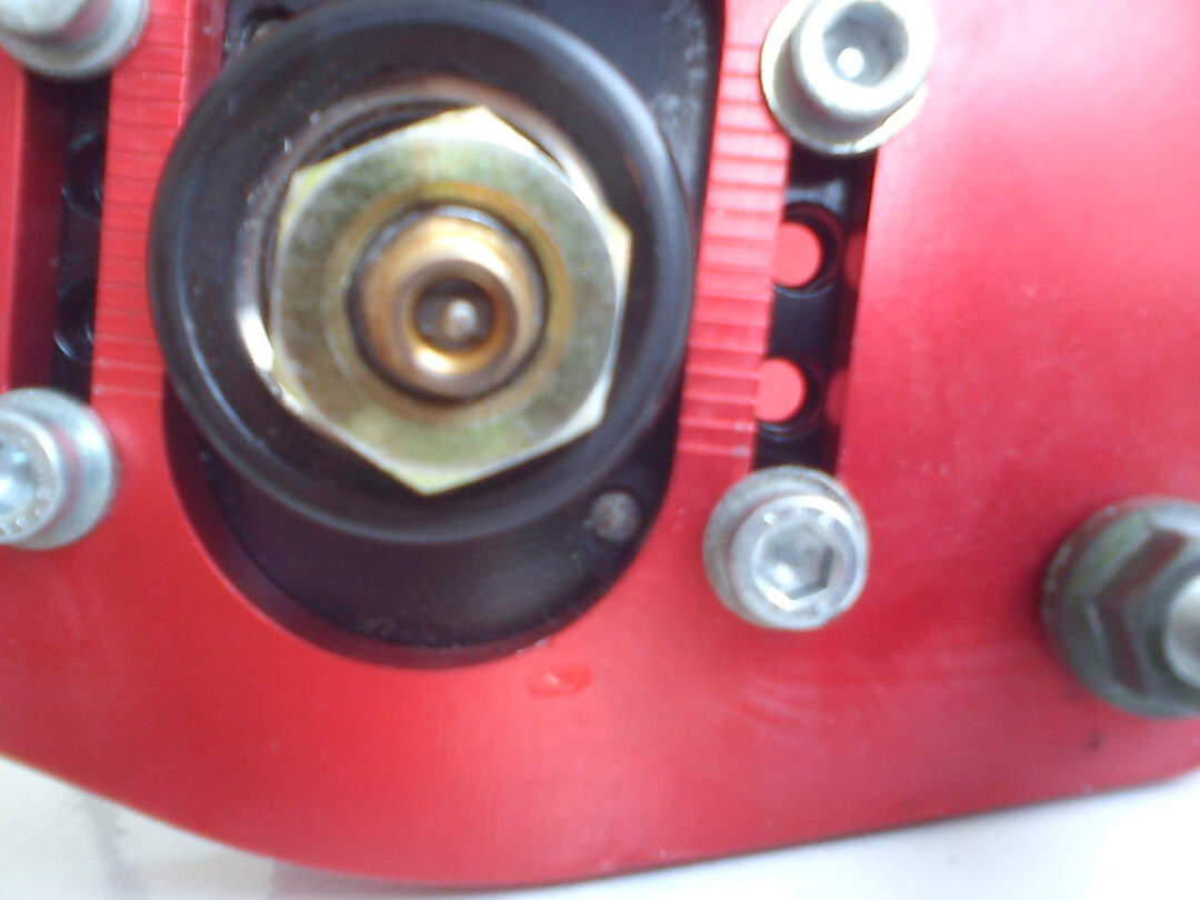

Sifus,
I just got this adjustable coilover for my corolla and i noticed this air valve at the pillow ball side. Anyone knows what it's for? If so, what gas to be injected in there and what is the pressure? It's a BuddyClub fully adjustable coilovers with inverted monotube design. Please advise.. I'm sure some enthusiast out there knows what it's for. Thank you!!!!

can u post pics from the bottom of the thing..
maybe it's a part of the shock absorber..

i believe that could be the air valve to inject compressed nitrogen into the abs. as you know, inverted monotube has the gas chamber on top instead of bottom.

i don dare to press it cos not sure wad will happen. Yes, it's an inverted monotube design, so the bottom of the shaft is for u to adjust the soft hard settings. So u guys sure it's to inject nitrogen inside there???

no need to press la bro...maybe the valve is use when you service and tuning the abs...almost can confirm it is nitrogen...and its commonly use in abs...even non adjustable abs have some sort of gas in them...and i berani bet its nitrogen...for the reason nitrogen is inert and abundance in atmosphere...78% to be exact..some high end abs use other exotic inert gas like argon and helium...for us mere mortals...nitrogen is good enough...

Thanks bro bera for your confidence and advice. I guess no need to touch it as long as my coilovers are not giving me any problems.
As for the gas pressure rating, any ideas or any tables/references that we can find??
