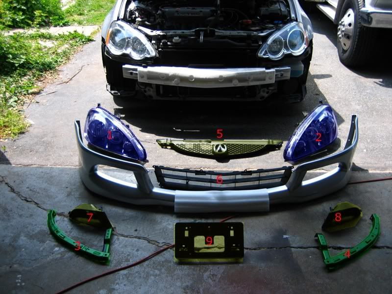

basically the conversion from 2003-2005 on DC5 will not require any cutting of your panels etc. its direct bolt on. but u must purchase all necessary parts as below:
1. Right Side Headlight- 33101-S6M-A51
2. Left Side Headlight- 33151-S6M-A51
3. Right Headlight Bracket- 71140-S6M-010
4. Left Headlight Bracket- 71190-S6M-010
5. Upper Grille- 71121-S6M-J01
6. Lower Grille- 71102-S6M-000
7. Right Fog Light Cover- 71103-S6M-000
8. Left Fog Light Cover- 71108-S6M-000
9. License Plate Bracket - 71145-S6M-A02
* part no are based from Acura RSX but it should not differ much with the JDM. rear end conversion is also pretty similar. :)

Hi all,
I think this is the fact that i need to change in front?

no. 5 is not inclusive of the red H emblem.. part no is 75710-S6M-Z11. but dont have the no for the 'type-r' emblem thats attached to d front grill.
