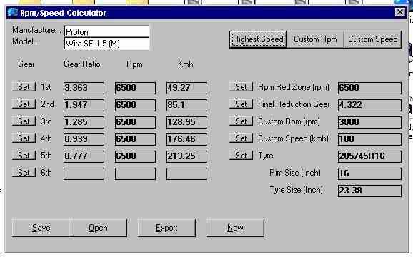

Introduction:
This is a simple program created by Microsoft Visual Basic.
RSC can calculate the maximum speed (km/h) from a car's gear ratio.
Notice: This is just a "theoretical maximum speed", which mean the program is not consider the power of the car engine. But the program is always accurate for the first 3 gear (manual transmission) and first 2 gear (auto transmission).
Sample result:
Manufacturer : Proton
Model : Wira 1.3 ~ 1.5 (M)
Rpm Red Zone : 6500
Final Reduction Gear : 4.322
Tyre : 175/70HR13
Rim Size : 13 Inch
Tyre Size : 22.8 Inch
Gear
1st
Ratio : 3.363
Rpm : 6500 rpm
Speed : 48.05 kmh
2nd
Ratio : 1.947
Rpm : 6500 rpm
Speed : 82.99 kmh
3rd
Ratio : 1.285
Rpm : 6500 rpm
Speed : 125.75 kmh
4th
Ratio : 0.939
Rpm : 6500 rpm
Speed : 172.08 kmh
5th
Ratio : 0.777
Rpm : 6500 rpm
Speed : 207.96 kmh
