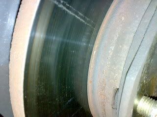

Anyway, just to share - what I captured last Saturday.
Its for the rear, as it says. :wink:

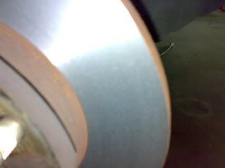

already post quote in proton saga/iswara threads :biggrin:
anyway in case you haven't read it here are my rear disc that you talked about.. mine printed mitsu. galant '92 on the hub..
bought in cheras for rm 230 a pair last year :frown:
twinpots on front too using all kevlar brake pads.. :biggrin:
with these i can stop 80 km/h within 10 metres i think :biggrin:

Nice dude. Really.
rm230 a pair that you bought - just the rotors or with calipers and whatnot?

unfortunately rm230 was only for the piring (rotors) only.... hmm.. but i got lucky to buy HKS SQV bov for RM350 that day one year ago ... :tongue:
nowadays la kan... i heard 2ndhand SQV could reach RM500 so i saved RM 150 so minus lets say rm30-rm40 from the rotors price now.. still save a lot...
lucky me :biggrin:
