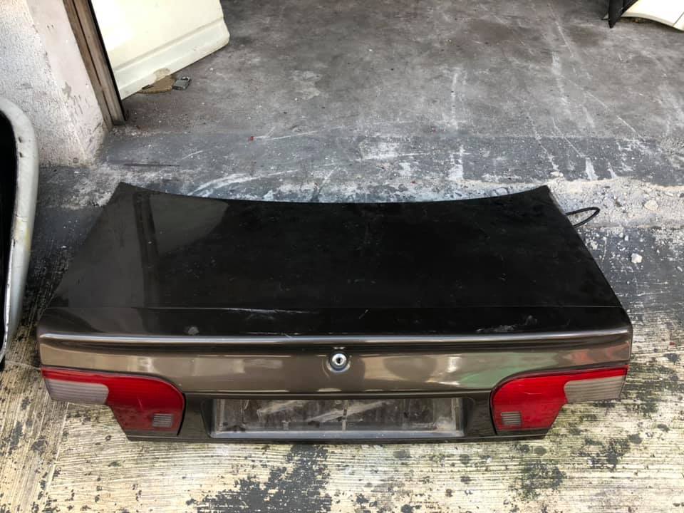

Cut and weld?
change the whole rear bonet. something in this picture. use back my original key and rear lights
