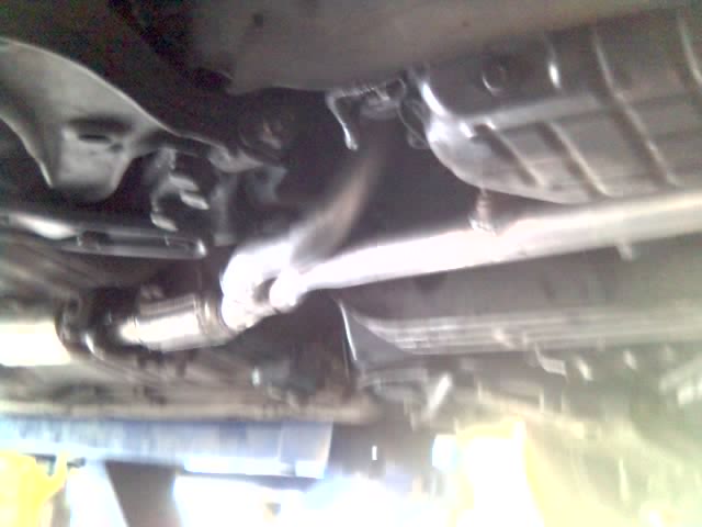

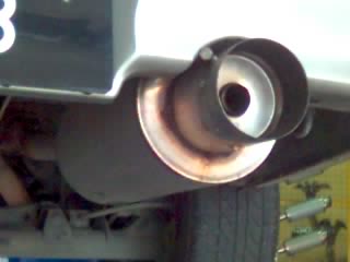

Hi guys,
I have a A33 VQ20DE. Changed my Y-pipe and put a bullet to replace the center box. I noticed the surface of muffler is rusted and there might be a hole soon as it's getting much louder since the day i fixed the y-pipe.
Wondering anybody here put a sport muffler on their cefiro? Currently im eyeing on Tanabe Hyper Medallion and Fujitsubo Legalis R. Uhm, mind me asking, are they straight flow or S-flow? I searched through the marketplace and noticed some Legalis R have their outlet near the arc of the oval, which stated as s-flow and some at the center of the oval. I assume that s-flow is more suitable for our cefiro, correct if i'm wrong.
Anymore recommended muffler in your mind for our cefiro? As quiet as possible, really hope to remain the 'silence' of our car..

d hyper is straight flow & thats wat im using now..consider loud oso
don know if they oso produce s-flow for hyper
for more quiet recommend 2 install a silencer(pre-muffler which usually in d middle)..u sure smile on ur face with s-flow

you replace the Cat, that why it get louder, the cat is also use to damper the sound. the bullet is a straight flow, it sure loud. Change to a good center box that will reduce the exhaust noise.

I guess there's different type of flow for hyper medallion, but not sure if there's s-flow. I was offered by JFA with their s-flow, which one is better actually, sport muffler or aftermarket muffler?
i removed the center box because it had faulty, FC drop to 350km/tank and the exhaust sounded too rough and loud. hopefully a good muffler will make the sound tolerable, or adding one more bullet perhaps.
ur muffler is ori one? my ori one also berlubang-lubang & come out wrooom sound...
haha
Yes, it's stock muffler. not lubang maybe, just the surface is peeling off. any area around selangor has a lot of chop shops?

jux tis week i hav change exhaust piping on my a32,centre box replace wif the aftermarket bullet and the muffler i hav change to the s-flow FGK,i think that was quiet to me so far.hope it can give u some ideas..........

no.i didn't remove the cat.if u remove the cat it will too noisy.i dun wat the spec.i jux know that is fujitsubo oval shape s=flow.

did mine at JFA with 2 flex pipe and 2 inch piping, cost me 480, which is a little expensive i felt.
i already took out d cat. can refer my thread. got pics there.
i wanna mod y pipe too but they quote me rm300++ which is overbudget for me..
u took out the larger cat(2nd one) only ?

Simple get a stock muffler , whether chop shop or brand new , end of the story. Quietest of the lot. Any sport/performance muffler will produce some sort of sound . Believe me, I have been toying around with exhaust systems since my 1st car (Mazda RX-2), hehehe..
Btw, quietness of our cars makes them sounds expensive..(especially inside the cabin)

I doubt if u can just reconnect a similar diameter pipe. Most of us will remove the stock Y-pipe, and redo a new y-pipe. Exhaust shop will know what to do. After removing the cat, if u still want the silence, replace it with a bullet or high-flow cat.
