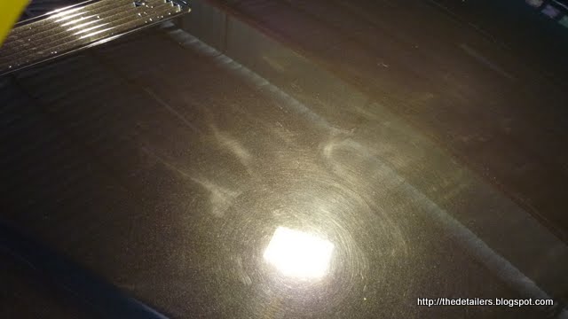

what is hologram? buffer trails?
who cares!!!!!....i pay 400 & i got my car ready in 4 hours while a shop ....u chop chop lo
master & visa card incoperations....what izzit...can use for shopping ke

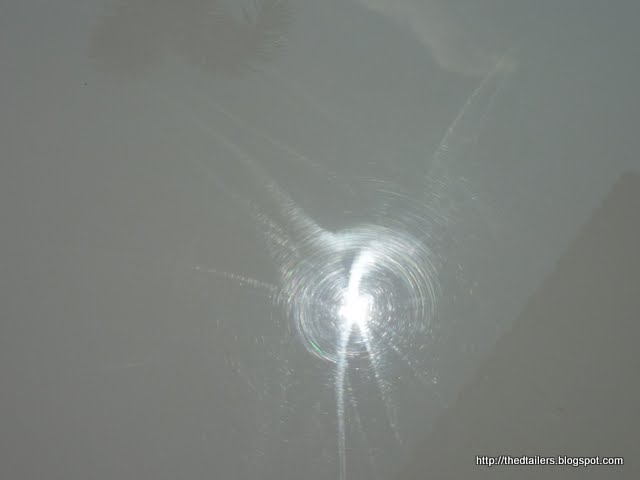

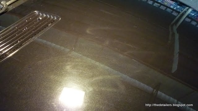

abrasion holograms, often reffered to as buffer trails or machine marring, which are microscopic scratches in the paint caused by micro marring
different strokes

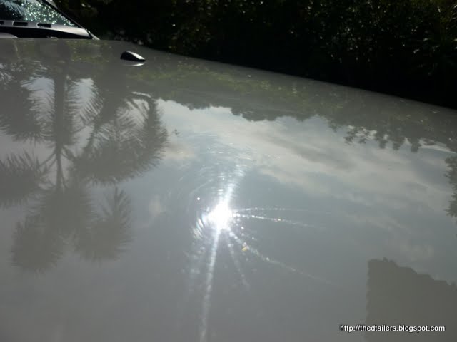

Another cause of paint defects are known as Buffer Trails . This is caused by the misuse of a polisher either rotary or orbital polisher, They occur when the polish pad has not been clean regularly, or over work product
btw only
Direct sunlight can make a car with buffer trails and holograms look exceptionally awful
note
so be attentive what they use to detail your car. is it a dirty foam pad or a worn out wool cover with jeans cloth??? do they have halogen light..or just using normal florescence lamp
