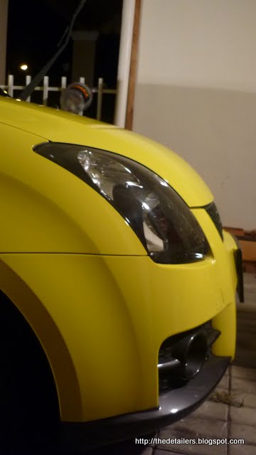

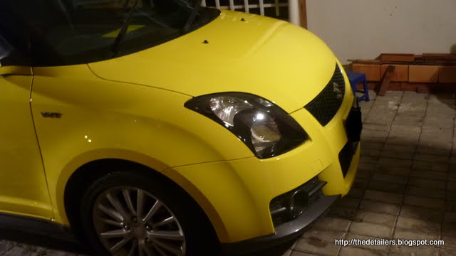

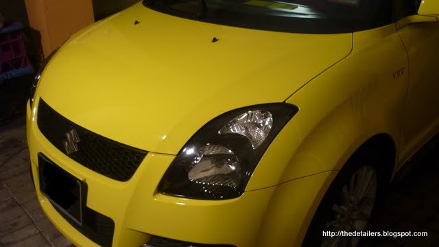

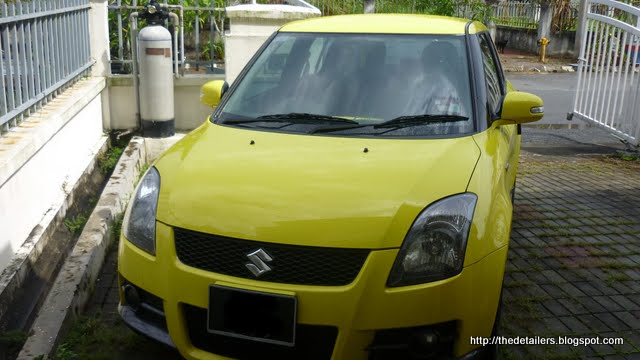

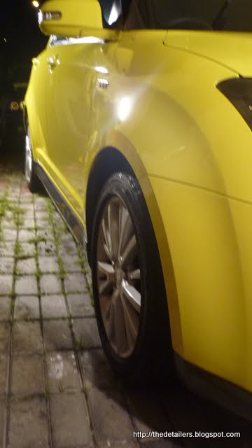

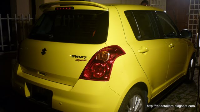

This is a brand new Suzuki Swift sport, fully import from Japan, which delivered to my friend. Good looking little ride. But later we discover a can of hidden worms – paint defect on a new ride, paint transfers…..more & more
Professional car detailer in Malaysia in training
I got to know him, through one of my public detailing session & he contacted me to him detail her.
Upon meeting up & viewing the car at night, without much street light....only with my little torch light, i discover patches of paint ..on the front engine hood. almost covered 1/3 of the right hood, only found out after his 1st wash & without realizing during the delivery time, he already complaint to the car sales man (of this defects) & he actually drove this to Megs detailing centre (they even did some wet sanding to demo to the owner) but not complete restore
what happen was ...the hood was repainted that quaterly & the car sales claims that it was some overspray......OVER SPRAY WHAT????? some paint flew from the car besides???? make no sense

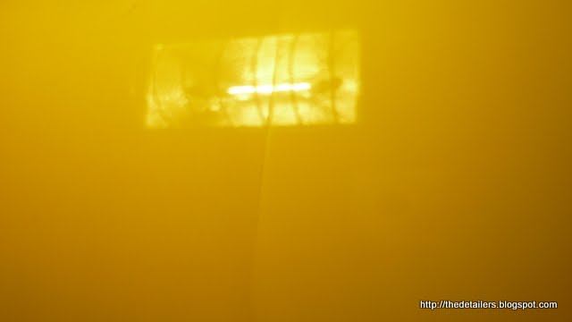

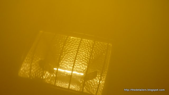

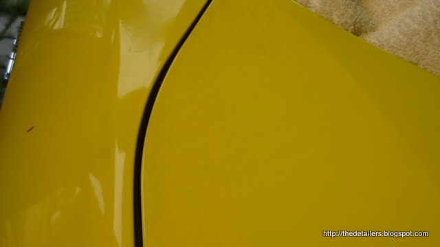

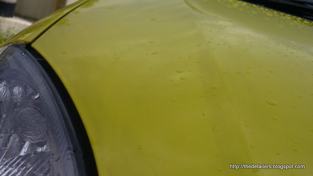

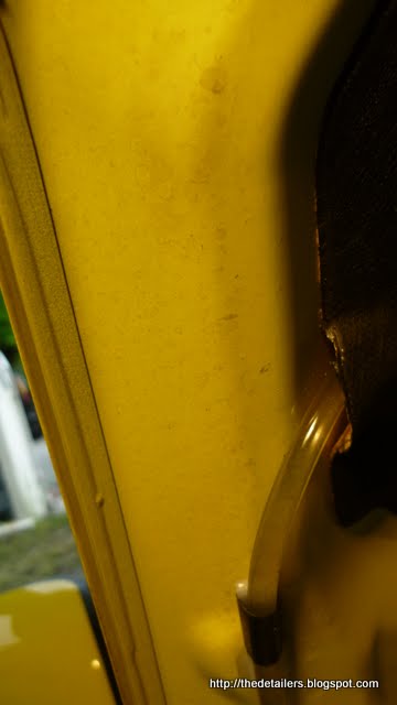

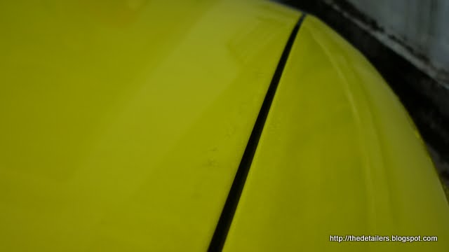

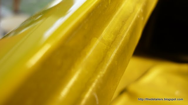

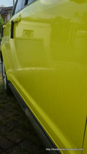

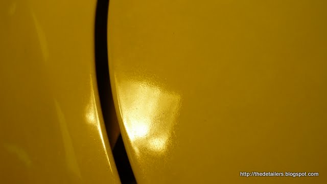

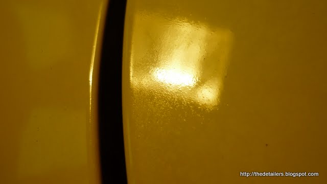

obvious paint defects with some underlining issue

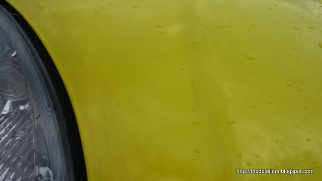

patches of stains only on the repainted area

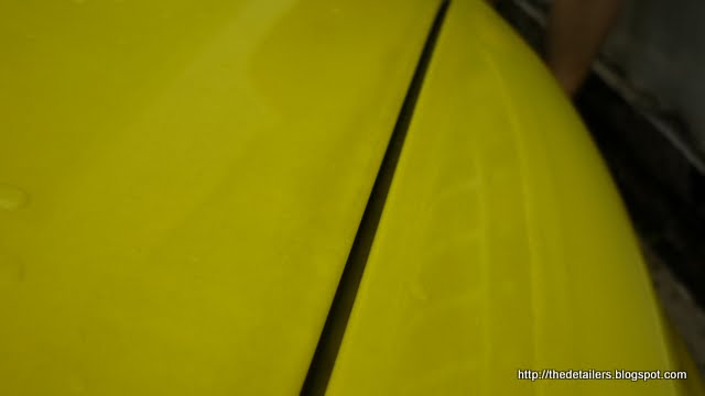

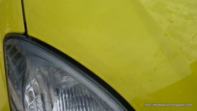

after wash, defects seems to be clearer

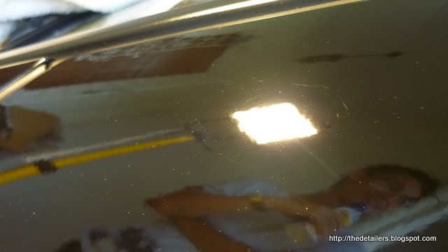

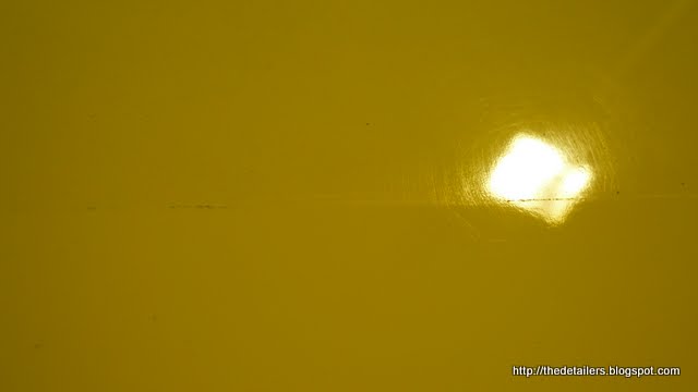

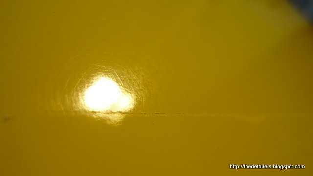

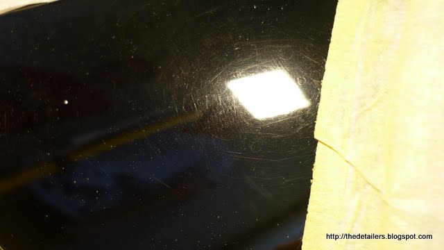

Before wash – look carefully on the scratches, lines & stains
Agitate with Optimum power clean 50/50 % comparison area , as u can see the upper hood is sprayed and showing cleaner than the bottom hood
Agitating with Power clean - most fine scratches & stain disappear but……………….not completely gone lesser effects
Although- most fine scratches & stain disappear but……………….
After wash look good but it resurfaces again

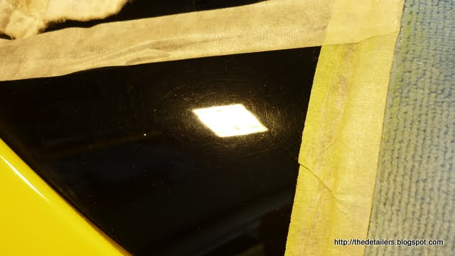

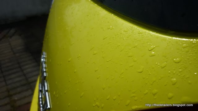

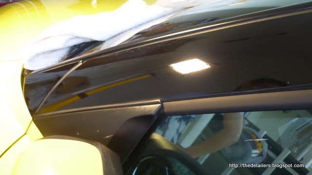

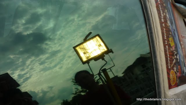

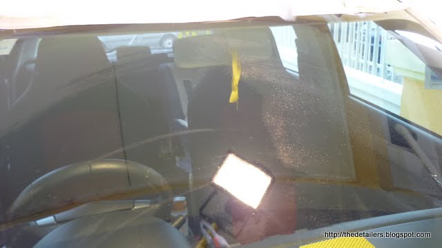

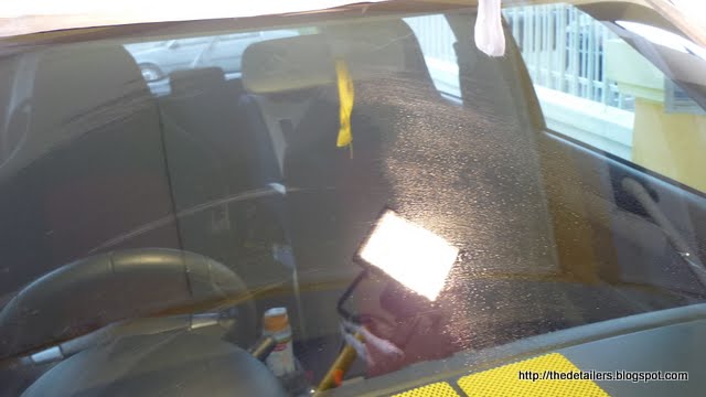

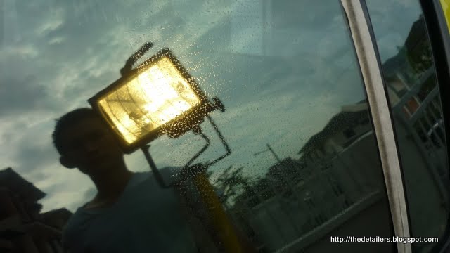

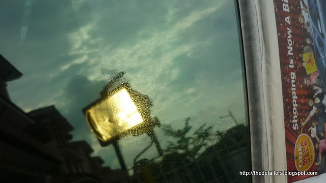

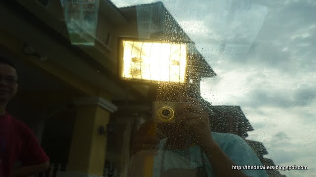

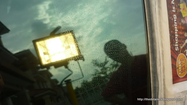

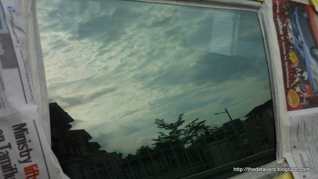

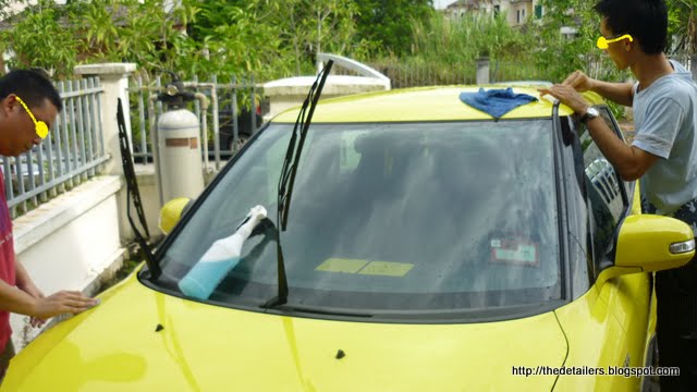

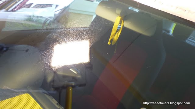

Once this is wash, I showed both of them how to clay. I went to check out the windows & glasses, discover a lot of water stains, knowing my friend constant going out station & extensive traveling, I decided to correct the windows

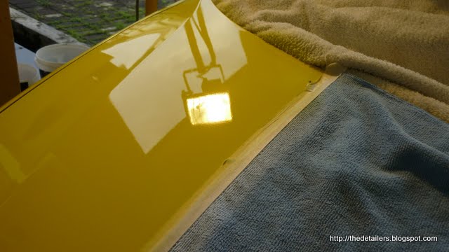

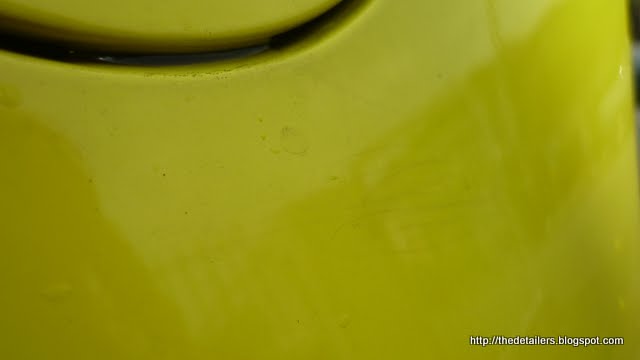

Remember the paint defects, 1/3 of the hood was resprayed before & the car salesman denied, where another detailing centre wet sanded on it….to my amazement, I discover that defect areas has stains & scratches too….
while both of them claying. I went to check out the windows & glasses, discover a lot of water stains, knowing my friend constant going out station & extensive traveling, I decided to correct the windows
Simple test, use a damp cloth & wipe over, if it leave a film of stains & has no clarity…it will definite stains your vision while particularly driving in the rain & at night. Taping off all windows rubber seals & plastic trims …
Took some pics before & after
50/50 area set
50/50
ta da
moving to front left windows

Glass cleaning – heavy water marks stain on all Glass polish (with rotary spread with speed 1 on single side wool & continue to polish gradually speed progression & eventually finish at speed 6 Makita)

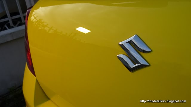

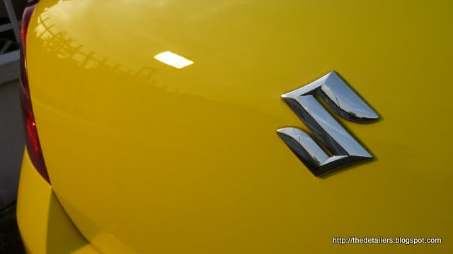

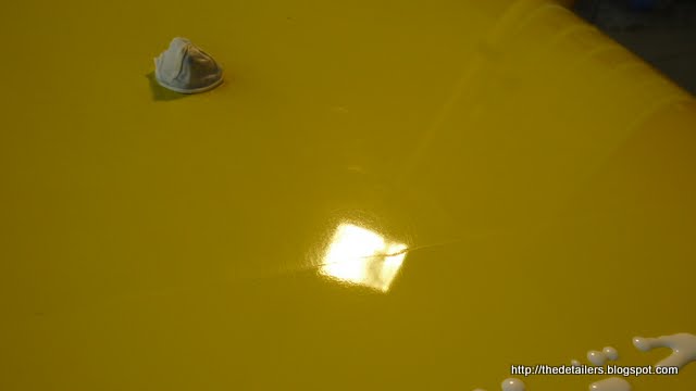

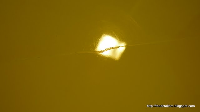

Pain defect – over sprayed & wet sanded before pics
______________________________________________________________________________________________
over sprayed pics
after corrections

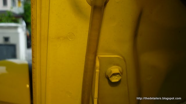

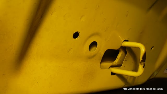

this is the evident that prove .....its kept a long time & uncover....look inbetween the paint the hood & inside the engine bay
more differential pics
more heart sick pics

pics under hood
more more evidence

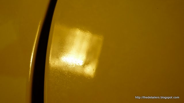

now the real issue........... over sprayed vs resprayed???? pics...
see t the imperfection of the paint
from a new CBU car??????
let me asked you would you pay for this???? agreed to go home with this condition from the delivery??
pics before corrections
pics after corrections
more at the centre hood...resprayed defects

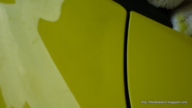

a 50/50 % area set
50/50 % pics
50/50 % pics
50/50 % pics

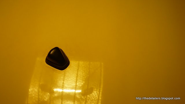

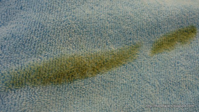

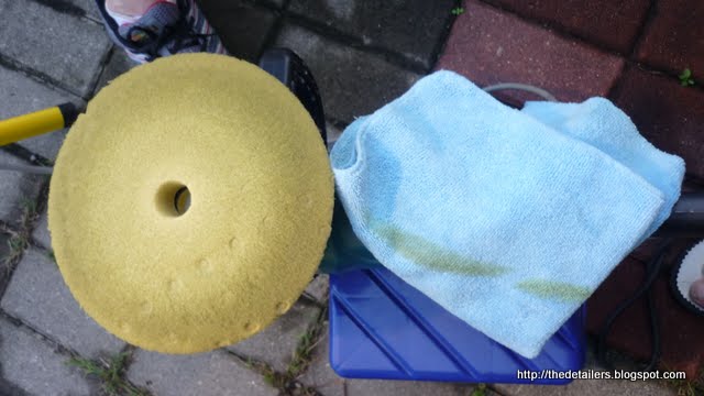

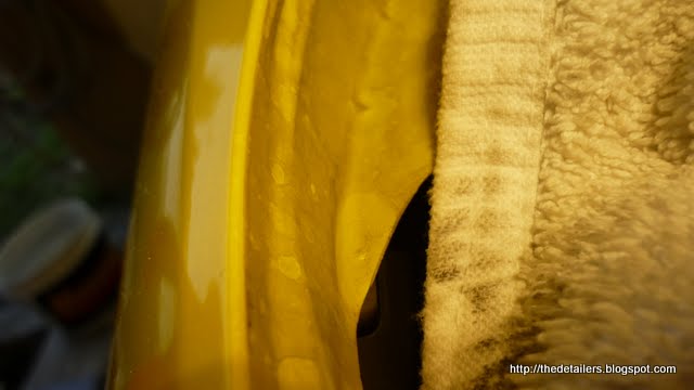

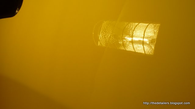

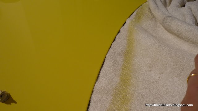

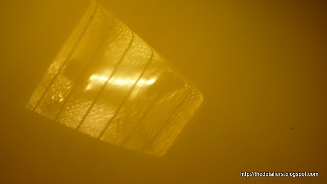

_______________________________ WHAT DID YOU JUST OBSERVED??? its a single stage PAINT_______

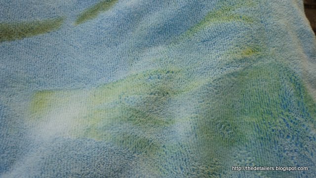

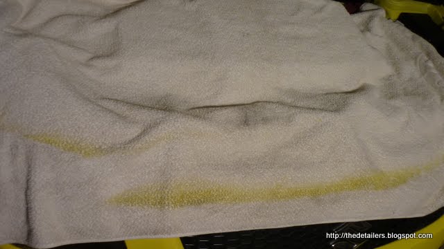

there is paint transference.....on the PAD & micro fibers
50/50 % pics

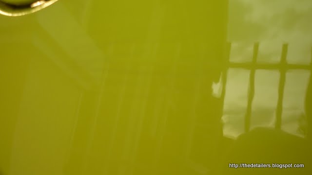

after
after ta da pics
look at the clarity of the paint on the hood
ma ma mia

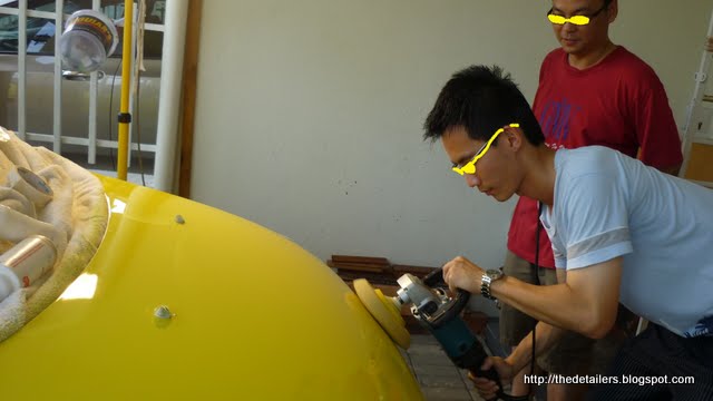

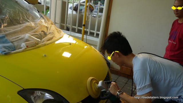

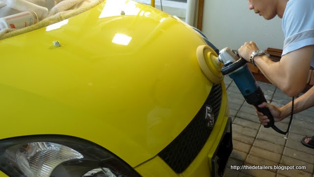

Now hands on time - lesson cont with handling the rotary & polishing
showed them how to hold the rotary
product use for each process
drawing the line of polish
spread the product - progressing in Rotary
thats is fun
yeah they enjoy themself

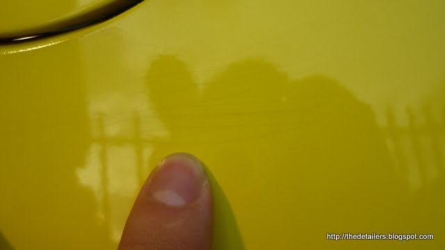

remember the petrol scratches
after
look at the paint transfered on the towels
its a sad thing....as its so much harder to maintained a single stage paint than CC
