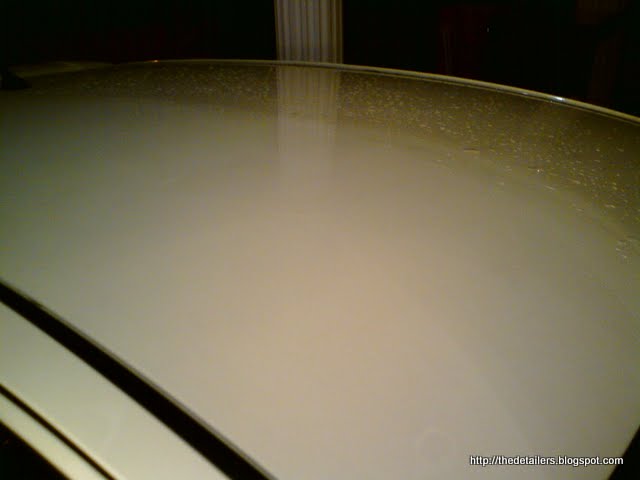

rear bonnet...dust & dirt accumulated

50/50 pics after ONR no rinse washed
the car left side is wash & glossy but the right side is dusty & dull with dirt

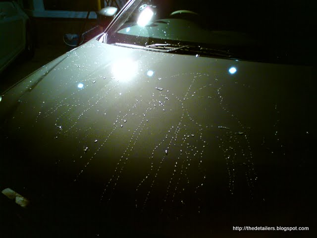

after a quick ONR wash, i purposely pour a bucket of water & let it glides down
& fantastic water beading after ONR wash...glossy looking hood

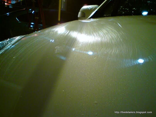

now....when i see this...i am just too angry....annoyed....felt betrayed & this was badly abused...
I took extra careful & care ....detailed here perfectly..but now this 9 months car look like 9 years old
i kept on asking myself...how could this be....what happens? how did this ever took place
she tell me....every sat they usually goes out for a lengthy breakfast at the market & send her car to wash......& it is only about 2 months (maybe 8 wash) & now it became another Frankenstein
8 wash & became this
even the a frame... was badly swirled up & cob webs is decorated on her
a few more heart sick pics......
can they just get away from this? after all these damages???

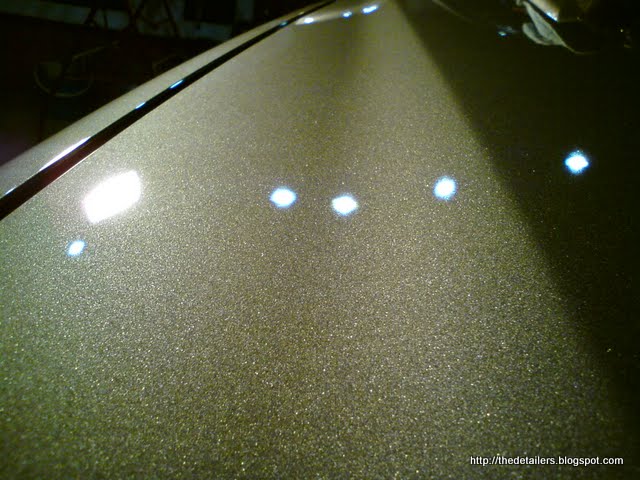

But thanks God, not of His hubby new car....even close up shot .... perfectly wash
ta da...wash & not wacked

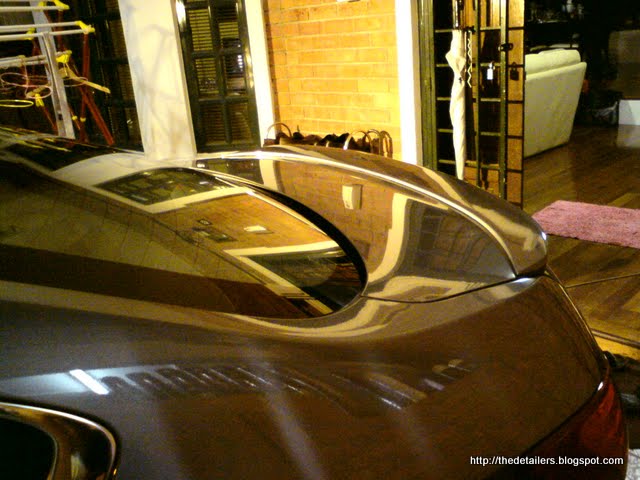

the rest pics is after detail....
I spent 10 minutes washing this Nissan Shyphl & another 15 minutes washing the perodua pearl white myvi & 25 minutes wax...with NXT & 10 minutes later buff off & UQD-ed
beautifully yours
ta da
ta da
ta da
ta da

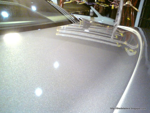

60 minutes wash 2 car & waxed another
the results of 60 minutes wash 2 car & waxed another
