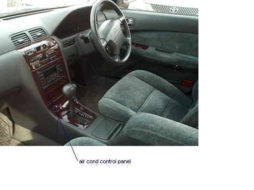

lately l had my cefiro air cond control panel burnt due to flat battery (over current). Now the air cond stay on all the time at fan speed 3, unless the engine off, otherwise there is no way to turn it off. l was advised to get the air cond control panel replace. Do you know any place l can get this?

Is not the A/C panel problem. Is the power transistor in the cooling coil.
01) If you did a/c service recently maybe the copper pipe touch the transistor heat sink and that also trigger it to auto start at 3rd speed.
02) You have a faulty power transistor. Get from chop shop is about RM 50 to 80. Get new one (not original) about rm 150

Hi Weikee, TQ for being so helpful, l will do it as your advice and let u know of the out come. Have a nice day o(~_~)o

just got the transistor replaced, is working!!!
thank you for saving my time and $$ to trouble shoot hear and there. Have a nice day!
