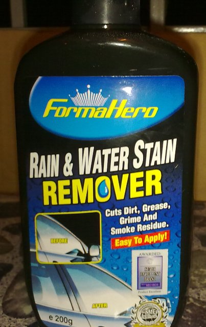

Guys, this is the windscreen culprit... Sorry for the delay guys... :)
Oh! he kena the FormaHero one. The same will happen with Tomcat one if you are not careful.....
Especially must be careful with front screen as this liquid will dry into white haze into the line of the wiper.
The method is to apply and scrub and rinse before it dries.....
