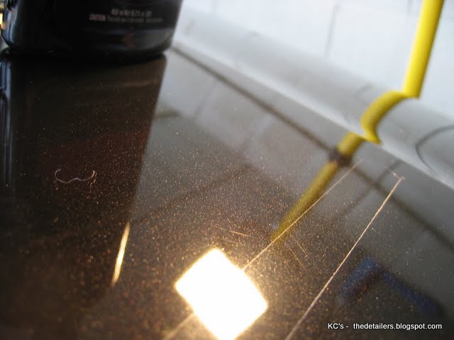

unavoidable swirls , RIDS & water mark
before pic
mostly contributed by the choice of cloths - esp - good morning cotten terry towel - ta da

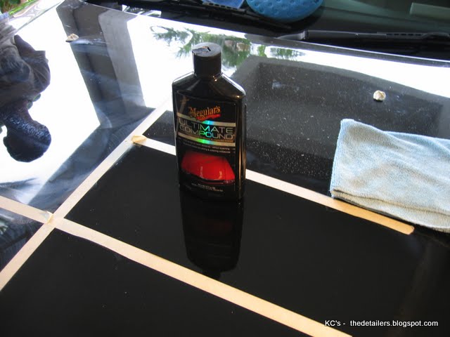

what we did was to segregate a few areas to test out the product & how it react over certains machine reaction
1st area for waxing with rotary
2nd area for consumer product with DA- basic polisher
wax applied prior polish
on rotary???

2nd area consumer range product
before
after
visible cuts is still there

2nd area consumer (OTC) product with DA
better but lack of clarity & definition
