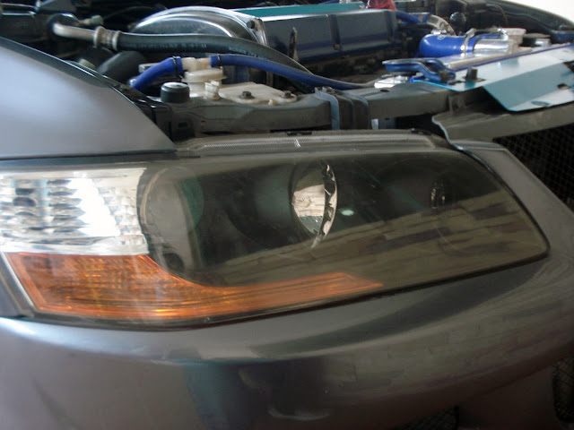

This time, the Evolution VIII MR

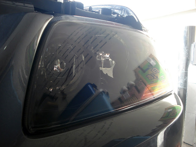

Note the blurriness and lack of clarity of the headlamp.

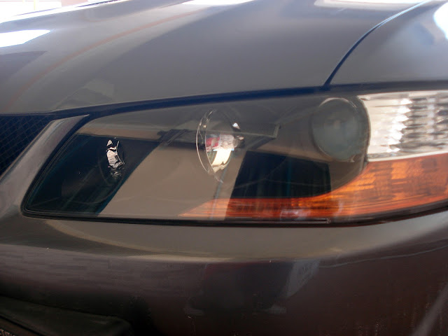

Lack of reflections too.

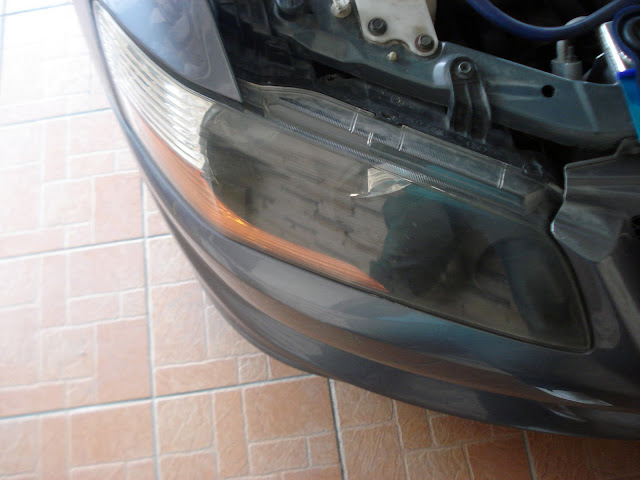

Same on the other side.

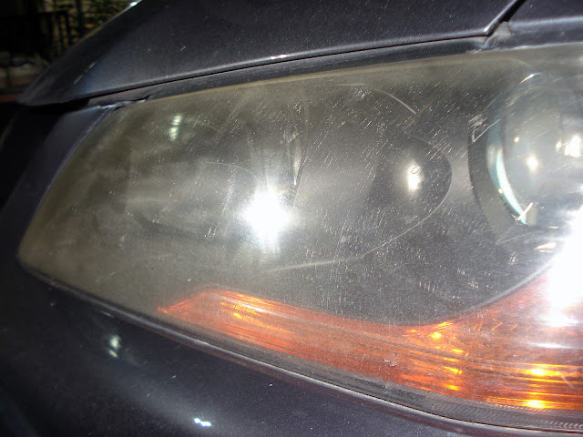

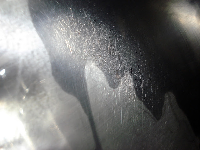

Close-up inspection with light shows a lot of fine cracks which appears as hazing from a distance.
The hazing is caused by many micro-cracks.

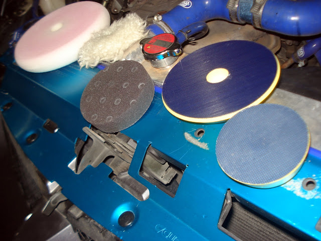

After sanding, polishing took place. Pads used were Lake country 3" wool and white polishing pad. Products were Megs M105 and M205.

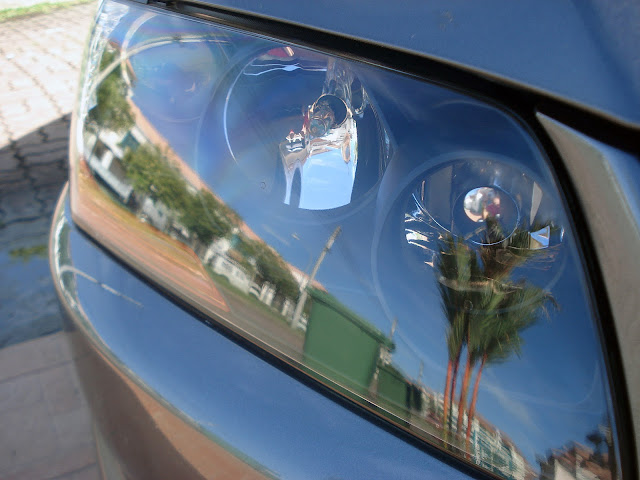

Reflects well...

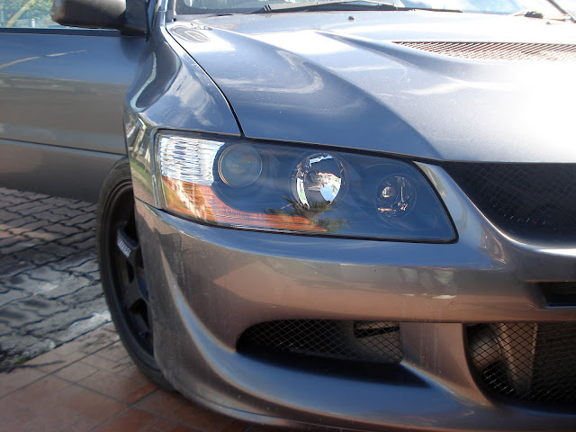

Clarity restored.

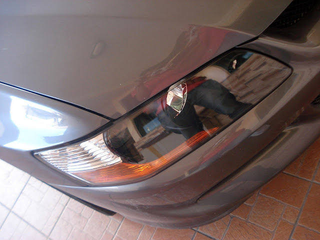

Some before-after pictures. Disregard the colour difference as it was a different time of the day.
50/50
50/50

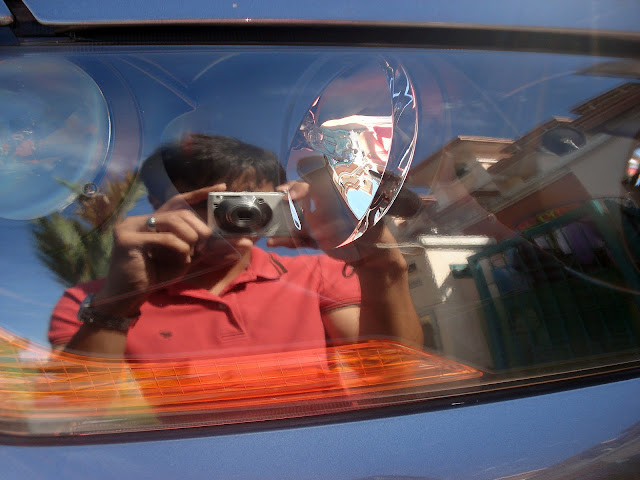

Hope you won't mind some vain shots well deserved after a meticulous crafting...
My favourite...
