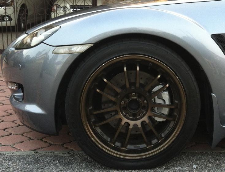

No no.. not for my Airtrek. My Airtrek has enough ground clearance eventho I am using Eibach Pro-Kit. I am referring to my RX8. Okay, I know I sud put under the Rotarian Forum but there aren't much response from them. This question is more of general actually.
Anyone has experience with bump stopper? I mean they are rubber rings installed between coil spring's spiral. This is to avoid the spring compress too much, causing undercarraige bottoming.
My RX8 is Mazdaspeed version, so it comes with lowered suspension. When driving alone or with my wife, it is fine. But with my teen kids on board, I scratch the undercarraige whenever I go over speed bumps around my housing estate. This is really annoying.
Installing bump stopper is the cheapest solution I can think of. My next solution is to sell the Mazdaspeed suspension and get adjustables which I am very reluctant to do so.
