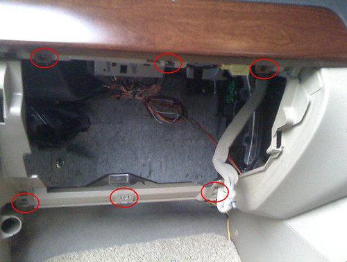

step 1. unscrew all this 6 screw.

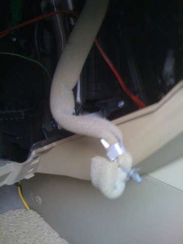

step 2. slowly pull out compartment & unclip compartment light.

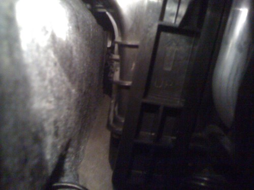

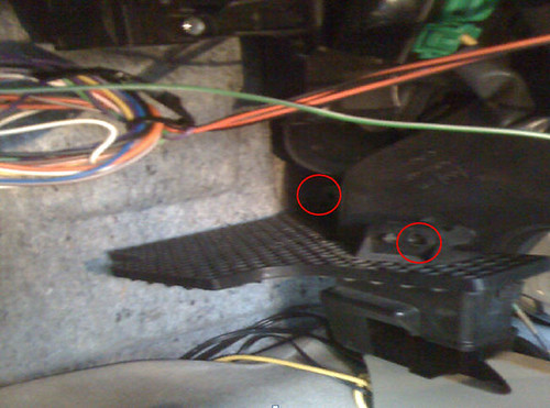

step 3. after comapertment had been taken out, on ur right hand side u will see this & unscrew this 2 screw.

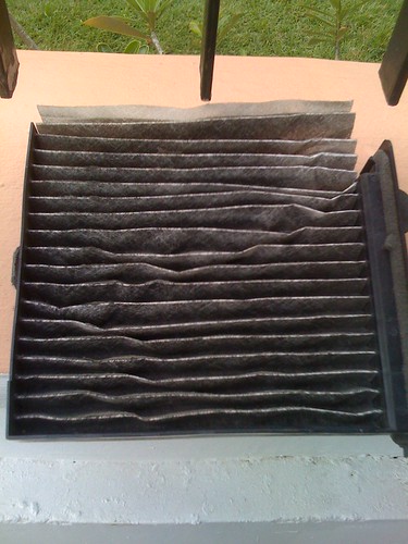

step 4. after taken out that part, on deep inside u will find air condition dust filter located.
step 5. slowly pull it out a bit& 2nd finger press down remaining inside filter *** coz the filter is expand type..
wow u see so damm dirty.

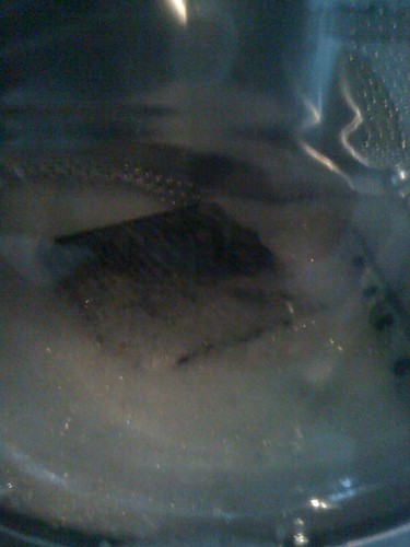

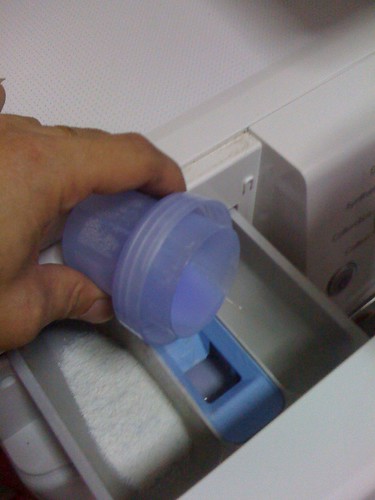

step 6. cleaning time, i use front loading machine washing to clean it.
and i put a little bit softlan for fragant purpose i think & some detergent.
and set timing for 30 min's clean.
set the thing rotate, plik plag plig plag. tat one is ok for ur washing machine won't spoilt.
after cleaning done result. not very happy.

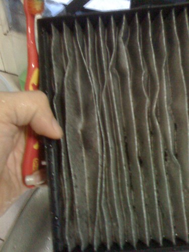

execute plan B.
step 7. flush it with tap water & brush with toothbrush (gosok gigi) won't spoilt filter due to filter is not really paper type.
with toothbrush

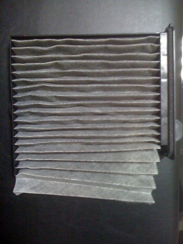

slowly brush it every layer & let it dry. final result will be like this.
step 8. install back, 2nd finger pressdown & slowly push in.
make sure is fully push in yah, be carefull the cable.
step 9. after done fix back everything, test the air cond condition.
air fresh, new wind blowing gently, fog haze disappeared immediate & the same amount of air blow compare last time are stronger.
