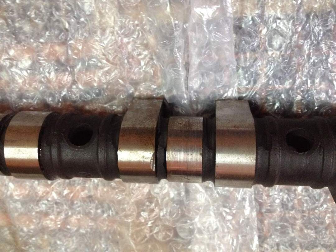

guys what do you think about this damage can give any impact on my engine ?
arrive from Europe last week,need some advise from you guys...
seller already tell me nothing worries about this.:hmmmm2::hmmmm2:
ken yeang
6,000 RPM
Feb 2, 2006
6,617
1,327
1,713
Even uneven surface of cam lobe can cause rubbing problem, creating excess heat to the engine. Worst case scenario is that the damaged part could chip off more....turn into metal chips to shavings, mix with your engine oil....and likely to damage other internal surfaces and bearings...
