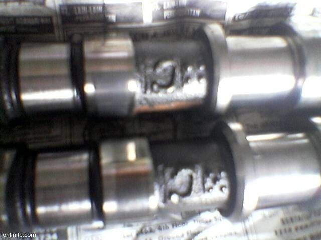

EVO 123 not shared the same cam shatf arrr? How to know or compare evo 123 and vr4 cam? i s there any part number on it??

u can easily identify the cam by looking at the alphabet(n few dots which i couldn't remember) of each cam. example :=
evo1- "J"
evo2- "C"
evo3- "B"
pic below showing a stock e2 cam
p/s=im selling off my e2 cam in de marketplace..hehe
