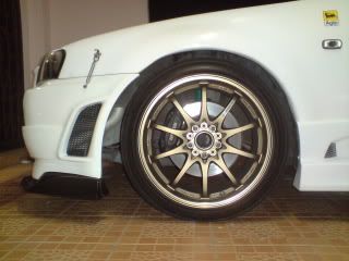

gtr_vspec
Aug 17, 2008
73
1,506
my ride height is between two finger, and not so low. :banghead:

eyong
4,000 RPM
Feb 20, 2006
4,083
53
1,648
Two fingers on 18" is probably a good height in term of handling and looks. Any lower you'll be looking for lower arm adjusters, camber arms and steering tie-rods ends to correct for arms, camber and steering geometry.

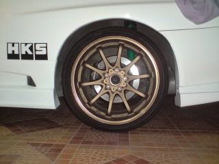

gtr_vspec
Aug 17, 2008
73
1,506
hitting 130kmh at bumpy road, back tyre alway rubbing
with fender. back and fronth at 16 click(hardest setting)
