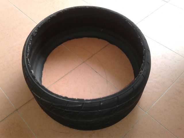

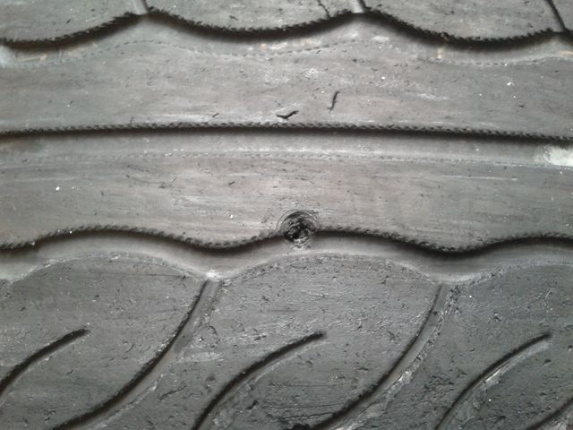

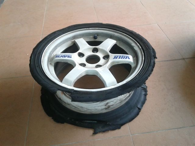

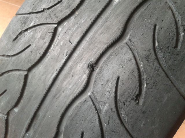

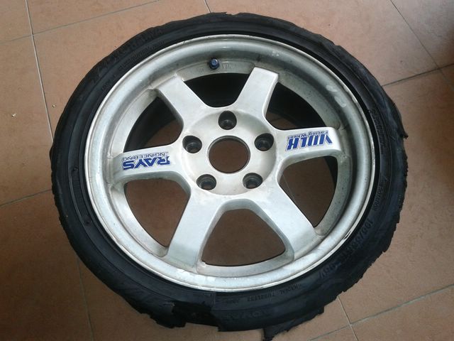

Hi, i was driving at around 160kmh today when my front tire decided to rip off like a donut and go rolling away in front of my car. Here are some pics. The funny thing is this is the second time this has happened and the way the tire ripped off was exactly the same. This time round though i kept the outer ring that ripped off and found a little hole that was caused by a nail or something. But my question is, how does the tire rip off a perfect circle like this. And twice?? The first time round i was using Toyo Proxes R1R's. That happened about 2 years ago but that time it was the rear right tire. This time round it was the Front Left. Anyone have any explanation to why the tire rips off like this?

that was what i was thinking. that the nail caused the tire to deflate. and i was driving to klia so yeah it was a long distance. but is it normal for the tire to rip in that pattern. such a neat circle?

oh ok. but my sidewall looked fine. maybe the nail caused a slow leak and then coz i was driving slightly far and fast it caused the tire to deflate faster and then rip like that?

I agree with those who mentioned that the cause is underinflated tyre.
Afew years back, when I went to Kuala Klawang with some friends, my Ke70 was wearing ad07 at the fronts.
Prior to starting the journey, I forgot to check the tyre pressure, and true enough, halfway enjoying the spirited drive/drift, my front left went totally flat, probably due to the soft walls, and inherently the whole tyre almost came out, causing me to almost lose control while taking corners.
So yeah, underinflated tyres would prolly cause the walls to give way, and since you were travelling fast, the sudden loss of pressure in the tyres cause the walls to collapse, and the edge of the rims sit on the walls, hence "cutting" the walls perfectly...similar to cutting pizza with the cutting wheel...

This tyre should not be too old as it is an AD-08. The nail hole do not look damaging and should have been be a small leak only. I think your tyres got deflated slowly and you did not check. The cutting of the tyres are due to the tyres running deflated. The rims were grinding the sidewall against the road, as you travel and the more it grinds, it cuts into the sidewall therefore tearing it apart.
That is why keeping the tyres properly inflated is very important......Even running tyres with low air pressure will heat up the tyres faster....
