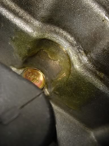

oil leaks have stopped for 2 days already. :) thanks to cold welding. so total repair costs : RM 9.70 (and some time waiting)
will post pics of the cold weld later.
found JB Weld in Ace Hardware and it costs a bomb!!! RM 51.90!!! wah lau. no point getting those la. just get any cold weld epoxy will do. usually can be bought from any hardware/DIY store for under RM10.

here's the pics of the patched up cracks using a steel epoxy.
looks messy but it works. no signs of leaks what so ever. :) success.
this pic is for the most severely cracked cylinder. didn't have a small enough spatula to spread the thing evenly so had to make my own from pieces of aluminum i had lying around.
