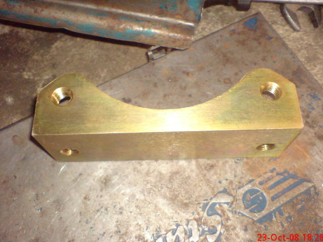

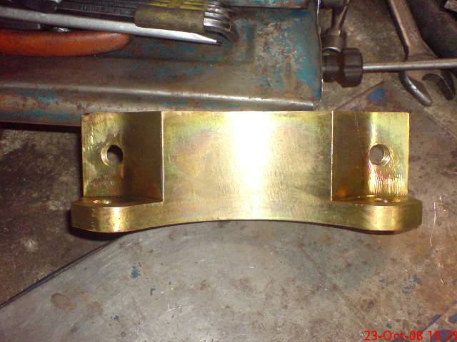

Parts and labour is around RM3800 :hmmmm: Engineering shop which have CNC tooling.I do it at my hometown Ipoh.
Status after development:
Yesterday do high speed test on the brakes. Result show positive. Brake no judder, no steering vibration but pedal position is a bit low. Still monitoring untill end of this week. 95% statisfied.
Parts involved
1 pair of Porsche Boxter caliper.(Monobloc)
2pcs Brand New VR4 disc
2pcs customise brake carrier
1 set QS brake pads

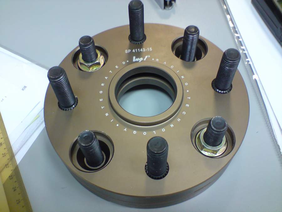

1pair 15mm Spacer Intergrated bolts & nuts

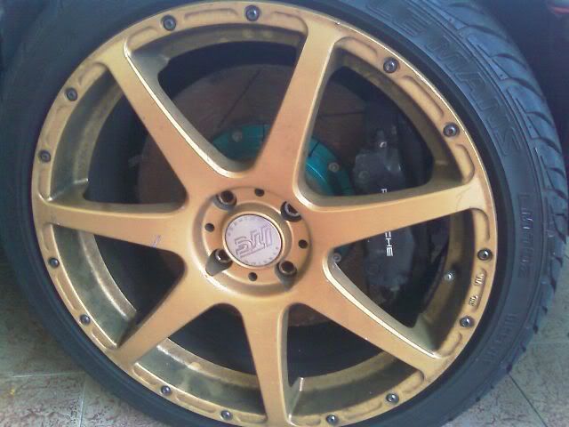

thanks for sharing bro.
btw,wat rim u using now?offset?mind to post some pic here?wondering the clearance between rim & caliper
cmng
Nov 17, 2003
3,289
72
Visit site

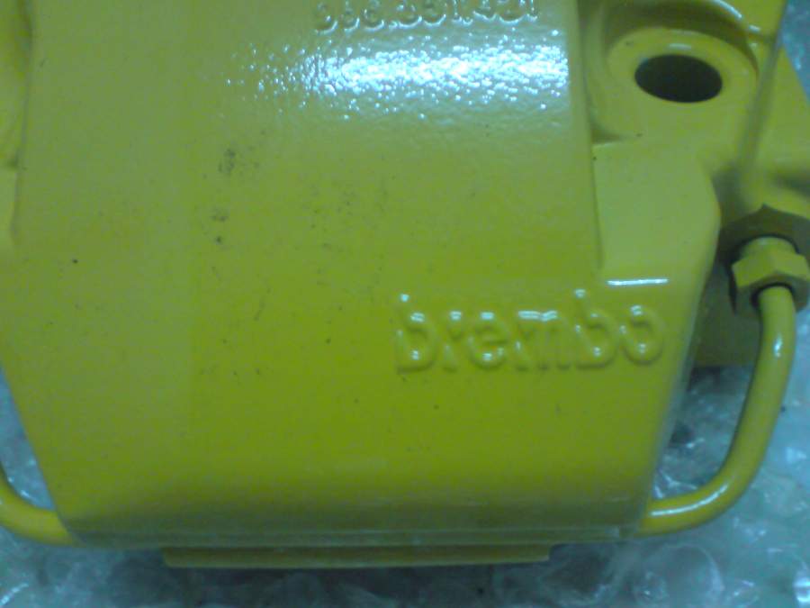

You no need spacer if you have the right offset rim
but i looked it look like porsche 24mm caliper
it either boxster non S caliper or Boxster S caliper
my porsche caliper can clear 17 x 7 offset 40mm Rim
mine is 996 front caliper with GTR34 324mm rotor
