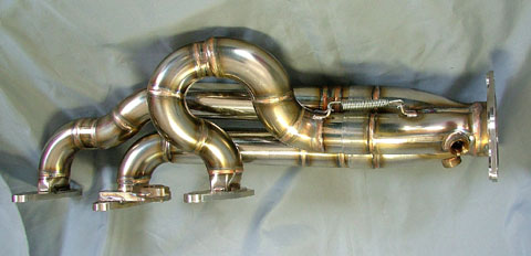

Mandrel bent is not 100% good for everything. The outer of the bent area will become thinner due the stretch (easier to wash out) and inner part will become 'kedut' (easier to crack when on extreme temperature sudden cooled). Muffler or intake maybe ok. Other parts may survive if the bent degree is not too much (also depends on the material and its thickness). Ceramic coated may help a bit but no guaranty if the theory works.
On the above pic, left side of the pipes visually looks good but if use at cat or header, it will not last very long. That's why high end or racing parts (light weight) always has a lot of welding. Can be bent if use thicker and heavier material.

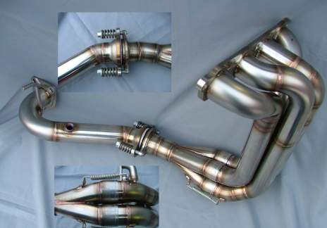

Today I happened to drive past JFA Motorsports aka Jaafar Exhaust in Sunway when I saw they had mandrel bend elbow joint pipes.
So I told them my problem about my exhaust pipe vibrating at certain RMP and also I feel my existing exhaust piping had too much back pressure until the throttle feels heavy when trying to rev to redline.
So they took at look at my exhaust pipe and found that the bends were not smooth as they were made by joining a few sections of pipes together (see pic below). Plus the previous installer (another workshop) mounted one of the mounts to a section of the rear suspension which caused me to feel the vibration from the exhaust pipe.
So the kind folks at JFA Motorsports designed me a new pipe using a few elbow joint pipes which were mandrel bend and produced me a new pipe in 1.5 hours as seen in the photo below.
My newly installed back pipe
So for RM350, I have solved my exhaust vibration problem as well as my back pressure problem. Now with a smoother flow of exhaust, I can rev easier to redline.
Here's a comparison photo between my old pipe and the new one:
