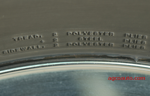

Anyway, u can always do a simple comparison btw your old vs current sidewall construction by looking at the sidewall ply rating. Hope it helps.
