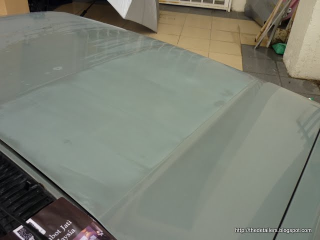

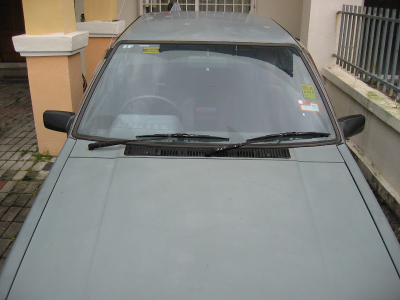

Nissan 2face, that what I called her….i may not have the luxury looking ride or paint but it has been always my passion to detail & to maintained what I have restores.
My paint on one side of the car is 21 years old of age & another restores last year & regularly maintained by bi monthly waxes & 6 months polish, as it is a non clear coated car (AKA single stage paint). Constantly facing the aging issue
A good classic examples…would be…our house gates & grills….as it need to be painted yearly, otherwise the paint become dulls & oxidized
The solution…a double stage paint was created to protect this aging process….clear coat paint……I may not have the luxury again to repaint my car…..but fortunate to have a special coating flown in special from US manufacture….AKA Alien coating

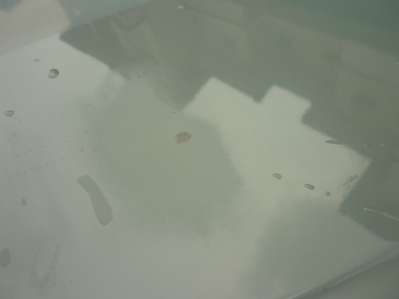

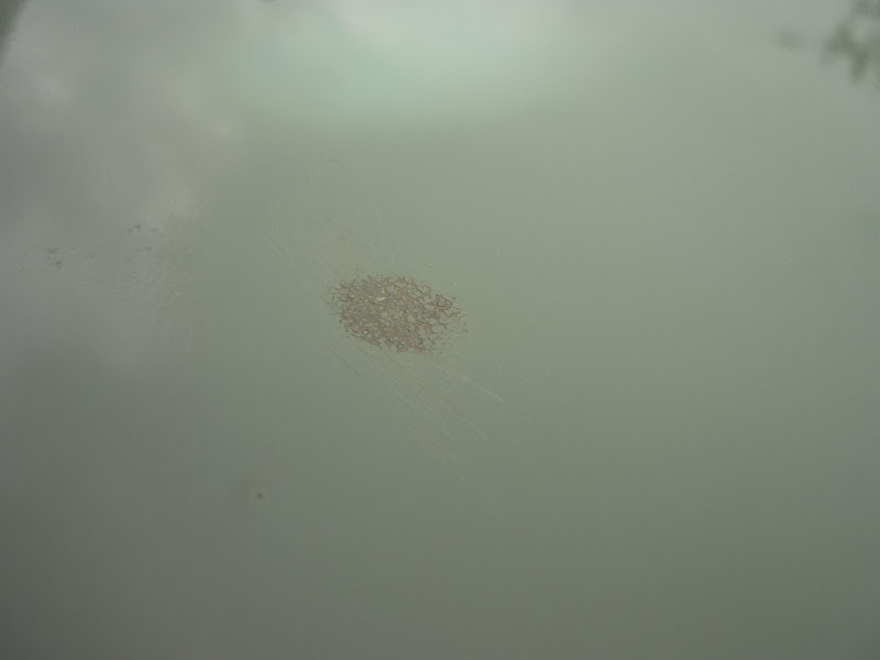

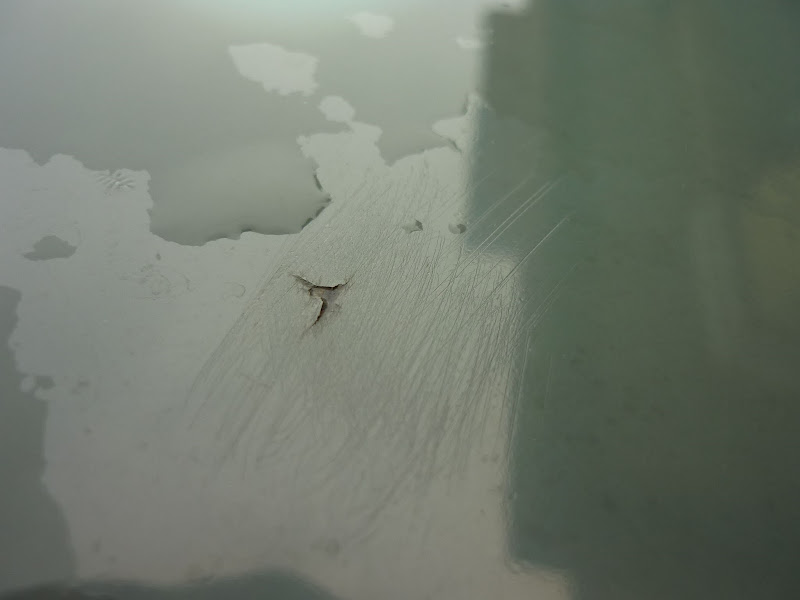

Paint defect correction…etched marked caused by prolong neglected birds dropping
spot wet sanded for testing
paint etched by this acidic droppings threat & wet sanded to level up & compound off

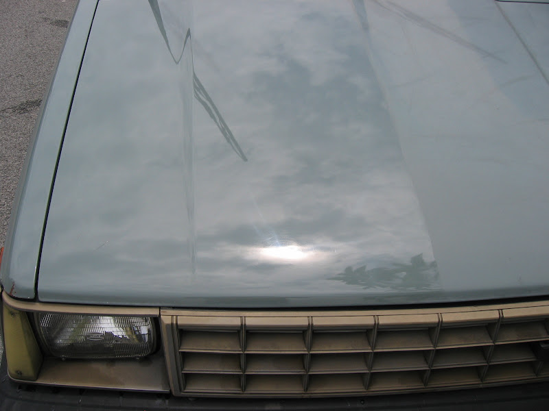

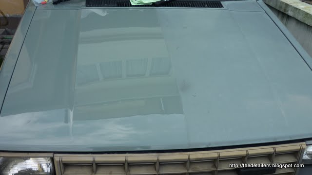

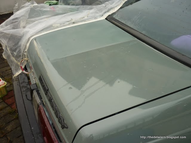

a prefect 50/50 % comparison picture…to show the 21 years old paint which was oxidized & another side that was corrected

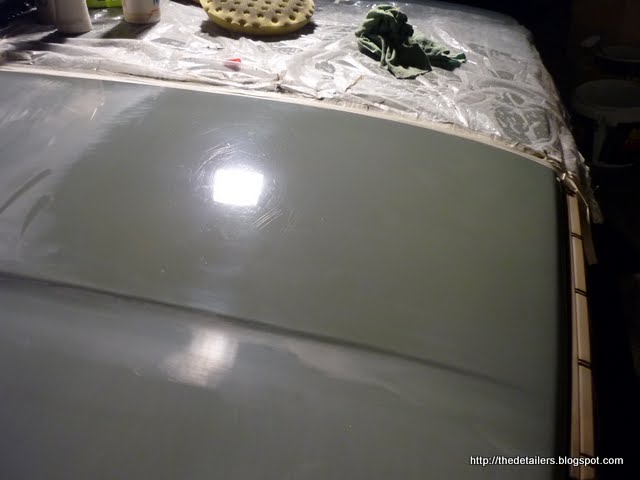

The sanding mark was removed by Megs # 105 with S/side wool pad , followed by Lake country Cutting pad with M# 105 & Polish by Megs 80 with Lake country Polishing pad
Another 50/50 comparison pic after sanding mark removed
there is some visible deep scratches is too deep to be removed…..as this car was terribly
neglected for 21 years & paint was just left there to be oxidized. There are countless area where deep scratches inflicted by scotch bright dishes scrub, some are more severe as it seems, it has been brushes over metal bristle brushes

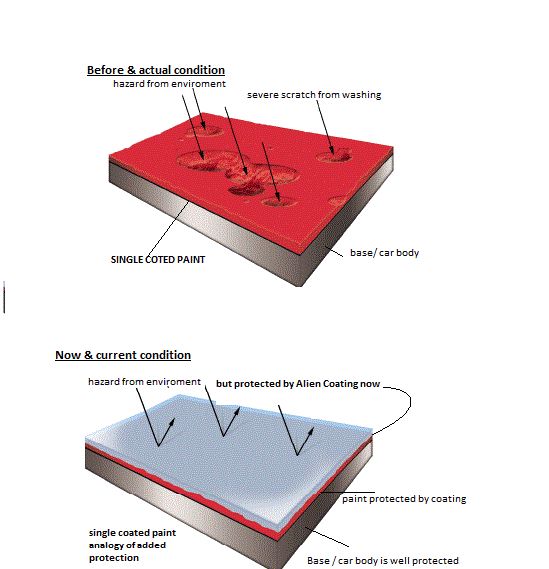

Intervention plan…to maintained this Single coated paint, with minimal effort

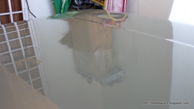

tada
prefect stage

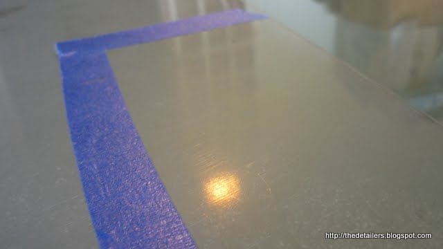

Apparently, this coating was design to with stand all harshness of weather & environmental threat. Counted my blessing to be able to attained this & having this extra ordinary water beaded results
Pay attention to the blue tape mark area
tape prior coating, it is an area that I coat without any corrections
Pics after coated applied

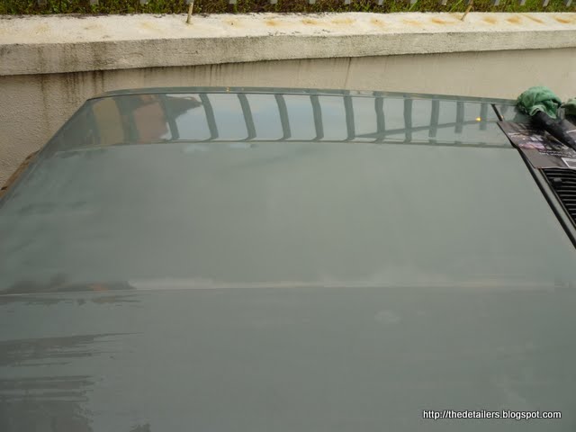

look at the 21 years old & oxidized paint

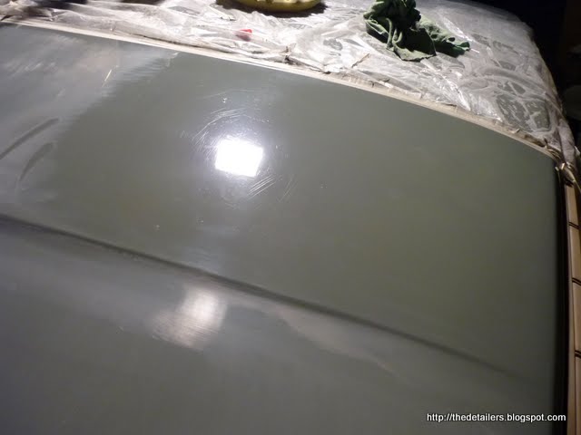

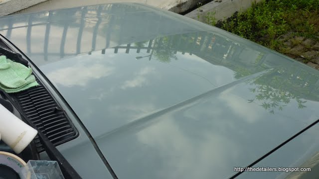

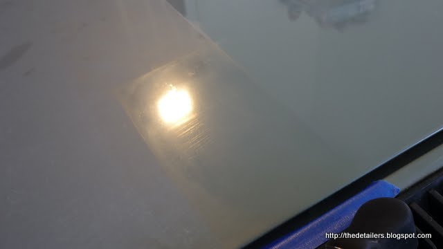

300 watt Halogen lamp is no feat even in penetrating thru ….dead paint…dull & matt

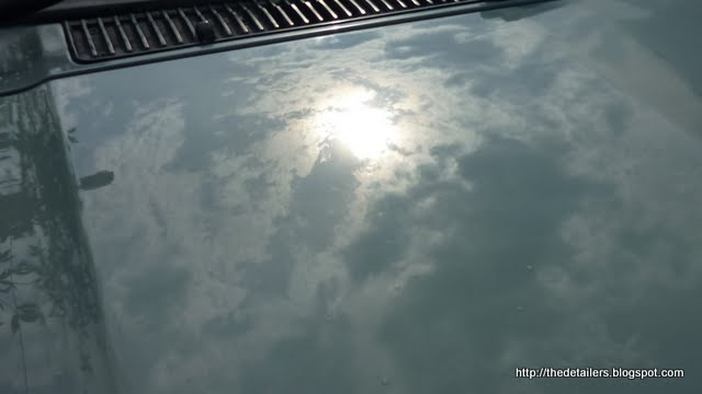

admiring the gloss at the corrected coated side ( on the engine bonnet area only)
tada pics

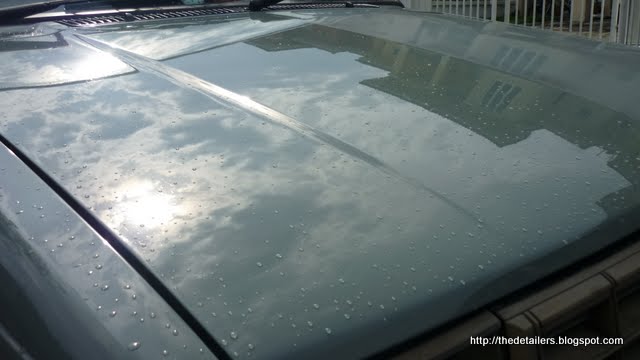

3 days later some sun light pics

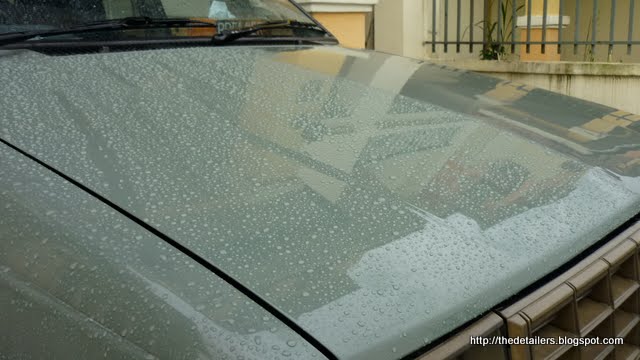

some beading pics after some sunny drops

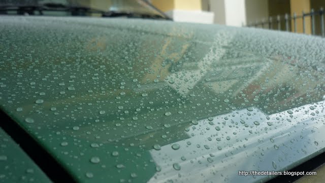

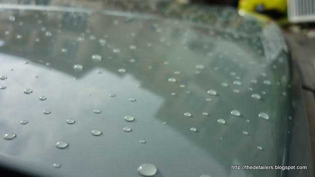

the next day …….midst

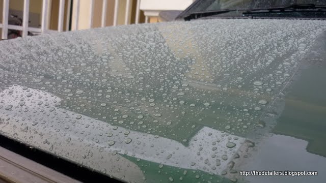

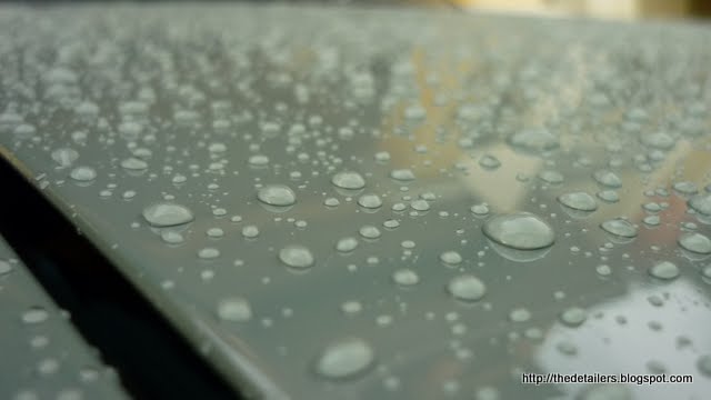

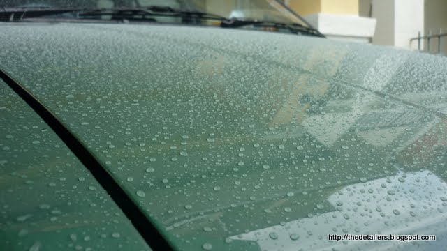

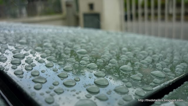

the roof part, Optimum ONR effect, water beading

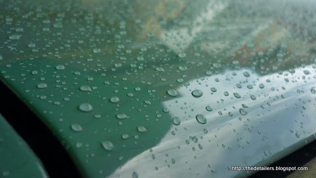

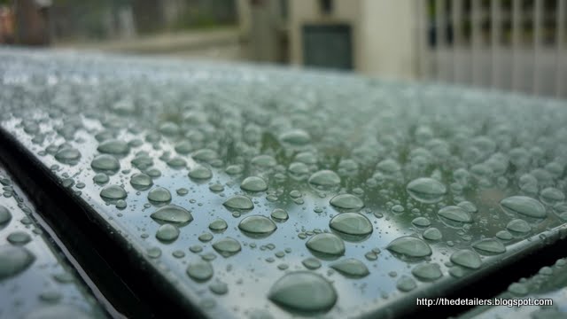

a week later
prefect water beading pics…that I personally have not seen in my entire life…..look at the semi circle shaped water that’s beads up because of the surface tensioned
8 days later

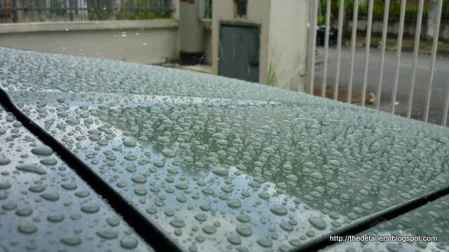

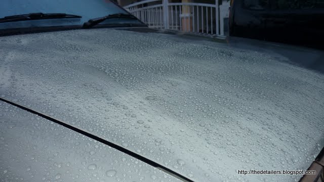

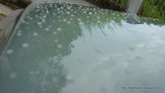

Another morning midst & after over night rain pics
http://lh6.ggpht.com/_RsduO4BD4FA/TA8htjoc0_I/AAAAAAAAI5s/JjxVMCvfj9k
[img]http://lh4.ggpht.com/_RsduO4BD4FA/TA8hxnZKDcI/AAAAAAAAI54/FraDuzjhdGo/s800/P1070335.JPG

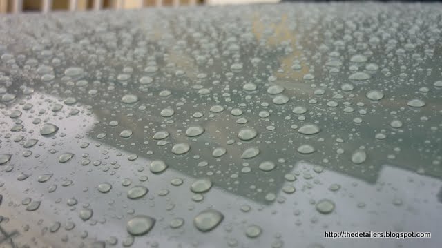

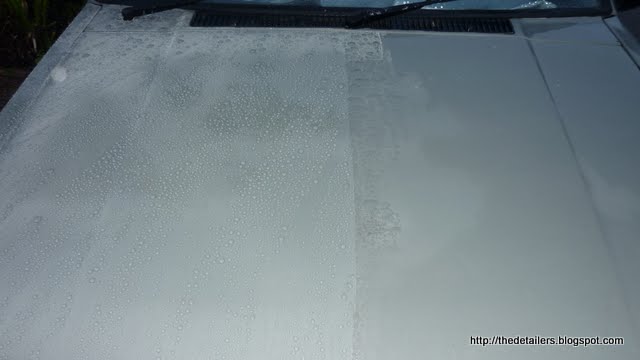

2 months later…another prefect moments again…rain drop on 2face

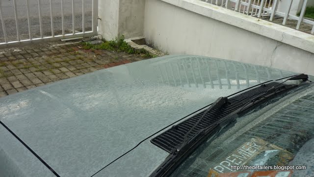

the protected side has better water beading & the neglected side water splattered…horizontally
another unbelieving water beading picture, that I never seen on any single stage paint
look at the clarity of the paint , remains even after 60 days

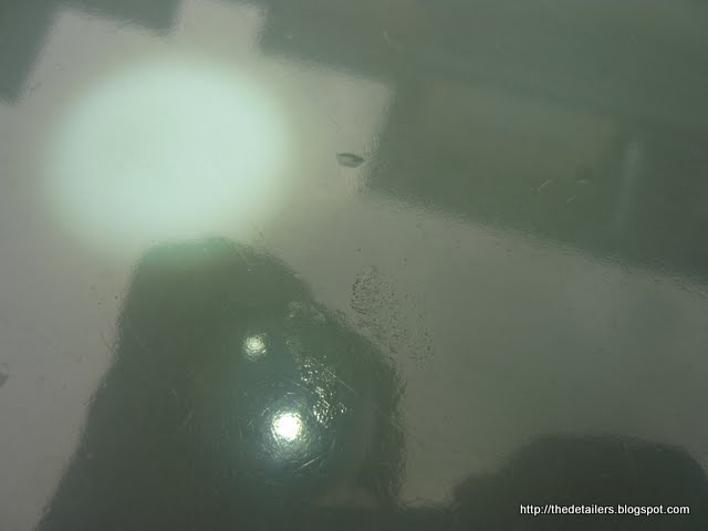

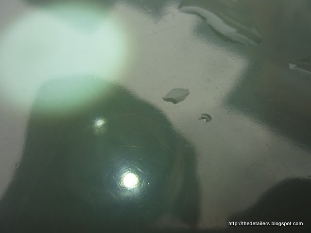

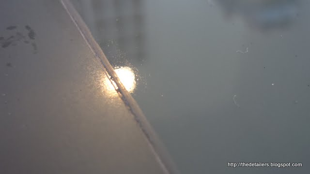

extremely close up pics
look at the prefect 50/50pics

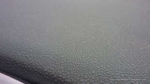

alien eggs???
extreme close up pics
tada pics
a week later
8 days later
alien eggs???
